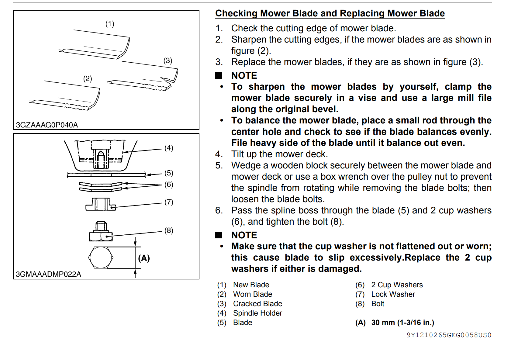

Yesterday at the Kubota dealer, I learned that the cup washers have been designed to keep the blade spinning properly. The bottom one pushes up and causes the top washer to flatten a bit but the bottom one does not flatten very much, holding tension on the blade. Two are required on each blade for the RCK60B-22BX. This mower does not have the cup washers on any of the blades! Plus, one blade was missing the lock washer.
Yes, a little "off topic" for a request for opinions on blades but it all works together. :)
TG

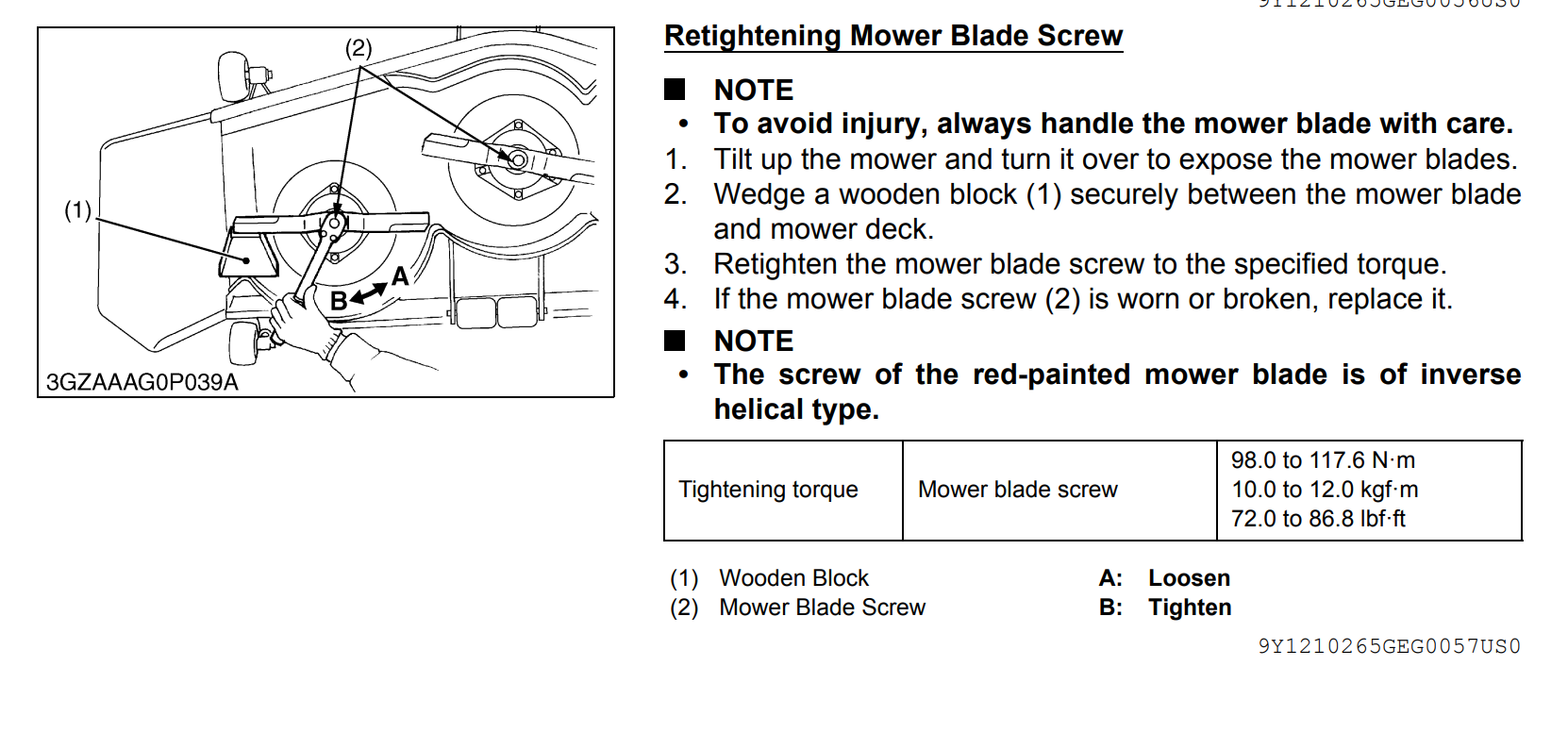

You might want to go to the parts counter at your local Kubota dealer. Someone remove the two cup washers and added lock washers? Lock washers are not needed if the bolt is torqued correctly. This info is from my ZD series WSM. My deck is very similar to your deck. Screenshot 2021-05-22 082404.png Screenshot 2.png

You might want to go to the parts counter at your local Kubota dealer. Someone remove the two cup washers and added lock washers? Lock washers are not needed if the bolt is torqued correctly. This info is from my ZD series WSM. My deck is very similar to your deck. View attachment 60274 View attachment 60275
I hear what you're saying, CGMKCM, but it's not the "lock washers" we all know and love. It is called a lock washer...notice in the diagram you sent. #7 is called a lock washer. It is the stop sign kind of lock washer. It fits directly onto the bottom of the shaft and is the same shape. No need to go to the parts counter. :)
TG
I get it now. On the Messicks parts site they refer to that #7 piece as a blade holder.

I have the 48 in deck. Diagram in the manual also shows cup washers. But in fact they aren't actually there on the machine. I've had it for 3years so far so good without them. I am sure the blades aren't slipping during use because I can see how clean it is on the spindle caps under the blades when I take them off to sharpen :)
