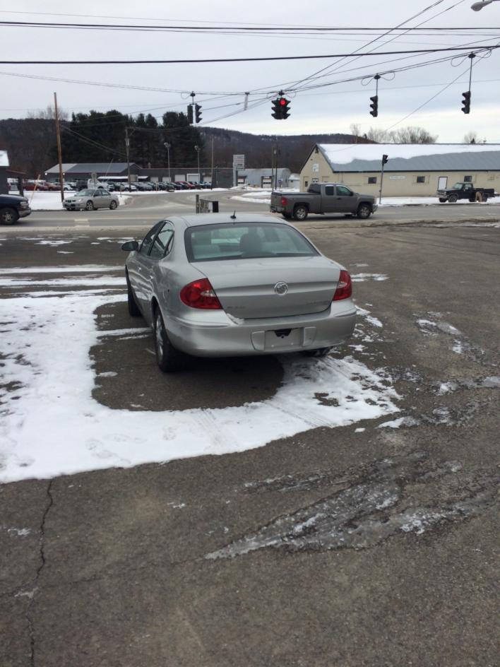

My son is nearing the faithful driver's test day.
Been looking for wheels. Repo auctions, side of the road sales, etc. Cheap cars are tough to come by. Upstate New York is rough on cars, chassis, bodies get pretty beat after 10-15 years.
Buddy has this '07 Buick Lacrosse on his sales lot. 3800 v6, 93k miles, and nice shape. Tires good, a little wear on outside edge of all 4, I'm thinking from driving underinflated tires. Other than that, car is real clean, and drives as tight as you could ask for.
The 3800 has been around a long time, probably 30 years.
He is selling his dealership, looking to get rid of remaining cars - $5,300. Per KBB, is in the ballpark, but more than we wanted to spend. Still less than he has in it, though.
Any good/bad experiences with these cars? I know many of you guys turn wrenches for a living, invaluable experience.

Like you said - good chunk of change for it - more than I wanted to go. The son is picking up some of it, and he's also buying new tires for the front with better bite, and maintenance from here out.
This has 225/60-16 and steel wheels. I hate aluminum wheels. Unfortunately, can't see the brakes well though the steel wheels.
My friend is pretty careful with his cars, so I'm sure the brakes will be fine for some time. Felt good driving it.

Al - I mentioned the little bit of wear along the outside edge of all the tires.
I'm thinking underinflated tires? Sound right? Had a similar thing on my own truck many years ago......
A 225/60-16 is common. Has a Goodyear something on it. Looks like a touring tire. Want something with more traction on the front. Haven't been a fan of Good Years since their OEM tires in the 80's.
I've had good luck with Firestone/Bridgestone. Like the FR6xx or FR7xx as an all season with a little more bite.

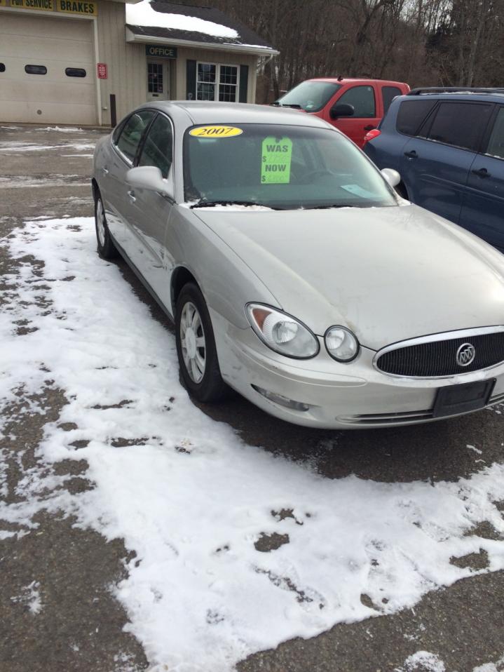

The most likely explanation for the tyre wear you see on the Buick is incorrect front toe.
Toe is the angle of the front wheels in relation to a the center line of the car front to back.
Reasons for incorrect toe:
1. Somebody set the toe wrong. Set it to factory spec at a tyre shop. Cheap fix.
2. Suspension or steering wear
3. Poorly repaired crash damage.
The first reason is by far the most common.
In saying this I am guessing that the tyres on the back were at some time on the front.
No point in buying new tyres unless you check the front toe as if the setting for toe is out the new fronts will wear in the same way.
The wear is very minimal, but I notice it. I've had similar wear on my own tires once for running my truck a few pounds under pressure.
I think otherwise the alignment is good, but have already decided I will watch it carefully.
