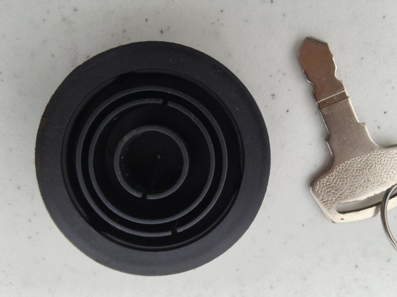

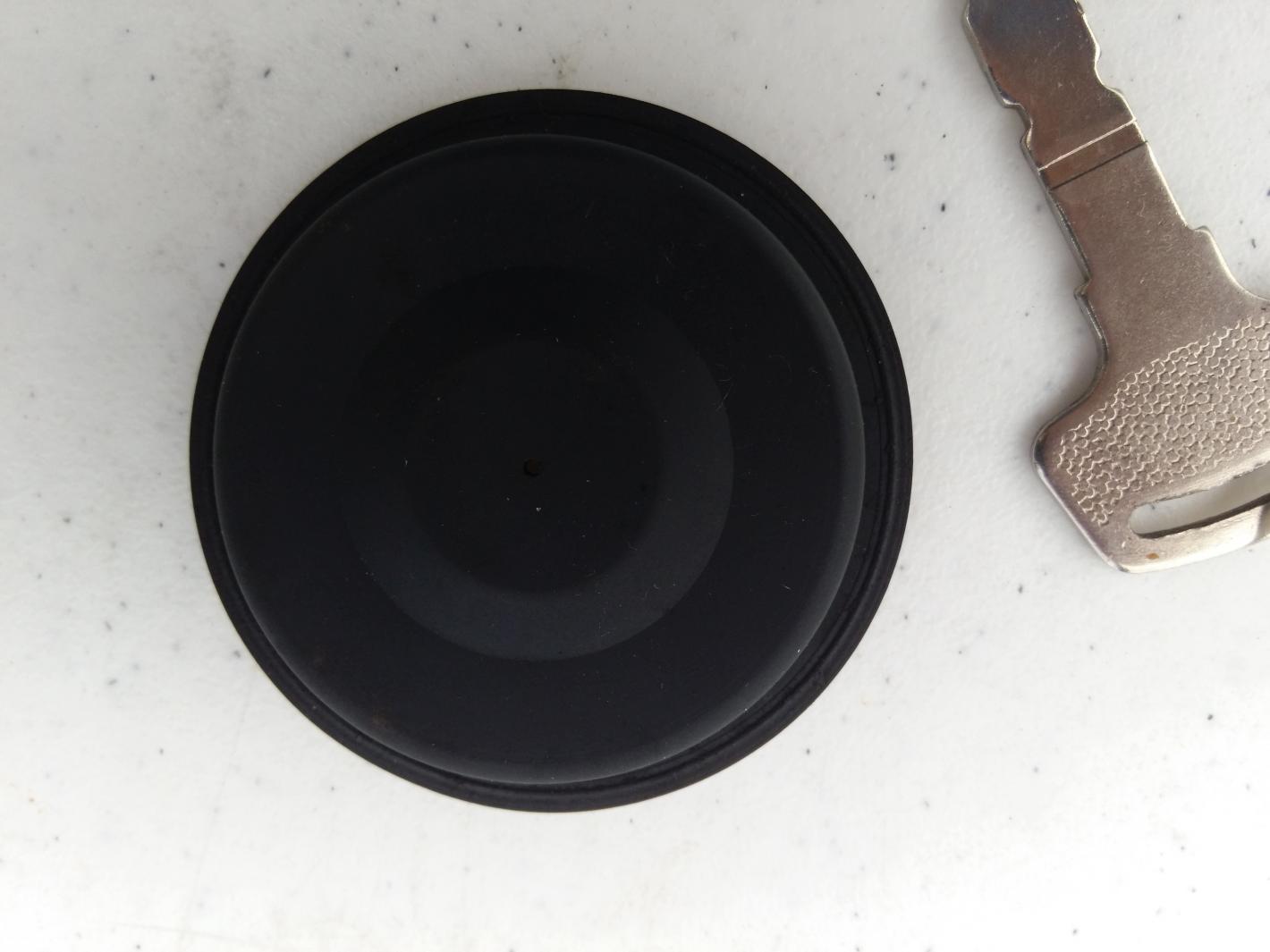

Thanks Dave, that's similar but not the same cap. I'm going to upload some pics of it, front and back, further down the thread. The "hat" is backwards on the one I have, there is only one flange (what would be the brim of a hat) and it goes into the machine. The thing is fairly soft, I'm thinking it gets bunched up a little and slides in, then expands to stay in place.

I still haven't figured out where this thing goes, and thank you all very much for trying to help me.
I do have a FEL but it's not that beefy and doesn't have those caps that Dave posted pics of.
This is what it looks like, see physical description above. The side with the concentric circles is the inside, the side that goes next to the machine and the other side is the outside. The inside had hydraulic/transmission fluid on it (it's a hydrostatic drive so both fluids are actually the same hydraulic fluid). There's a tiny air breather hole in the very center.

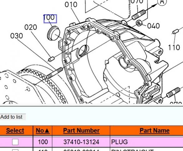

This was my first thought?
Looking at the parts diagrams I thought that might be it too but that part is much smaller. It's only about an inch and a half and it's sort of "upside down" to the way my lost cap appears to attach. My errant part is nearly twice as big around as that one.
