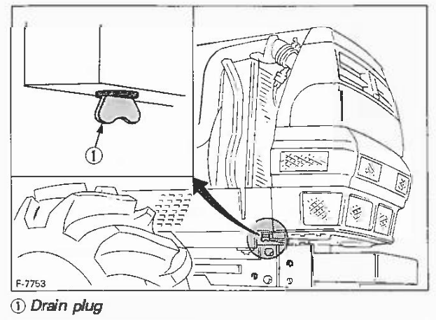

I recently acquired an L3600, which doesn't look to have been well-maintained, though it starts fine and runs like a watch. However, winter is coming and I want to make sure that the coolant is more than just water (though it seldoms freezes hard in this the coastal UK). Problem is that I can't find the radiator drain plug which, according to p.65 of the manual, should be a kind of wingnut more or less in line with the radiator. In can't see anything like that, though I haven't removed all the panels yet...
If the worst comes to the worst, can I just remove the hose coming out of the bottom of the radiator on the right hand side (looking forward from the cab) and drain it that was?

It 'might' be that mangled black mess,already twisted into an unrecognizable mess ??
If that drain plug is PLASTIC, I urge you to NOT attempt to unscrew it. Have seen posts here where the PLASTIC breaks and you're in real trouble. pretty sure most just loosen the lower rad hose, accept the 'mess' and carry on.

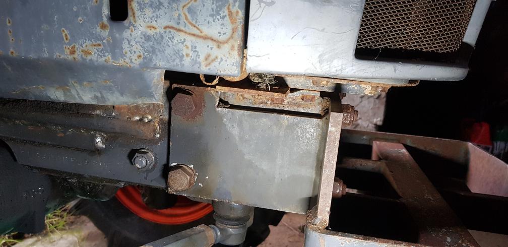

If that little hose runs from the bottom of the radiator to the block near the oil filter and injector pump, yes, that's the best place to drain the whole system.

You should be able to purchase a tester at your local auto parts store to tell the freezing level of your coolant mixture without draining it. I never found the radiator drain on my last tractor so I simply detached the lower hose. Be sure to use only distilled water with the anti freeze in your cooling system, never tap water. The same is true for your battery.

they didn't all have the wing-nut style. Some had a hex with a slot in it that a screwdriver would fit. Or a 14mm wrench (IIRC). Kinda hard to see em. RH side of radiator, bottom, buried, and often has a bunch of grease/mud/etc on it

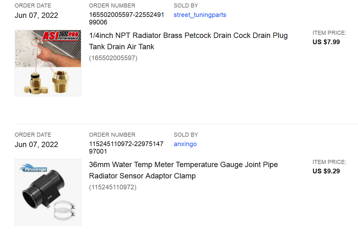

Something I did to make draining antifreeze easier when you've got a radiator with no drain (or busted drain) is to use parts like those shown below. I had plenty of room in the L35 where the lower radiator hose runs from the radiator to engine to install this. When the time comes to drain I think it will be a cleaner job.
BTW, I had to increase the size of the hole and retap the pipe joint to fit the petcock in my case.

Thanks for all the helpful responses and suggestions, which I am thinking about. I will go and take another look later, but for now I have attached a photo of what I think is the radiator hose...
