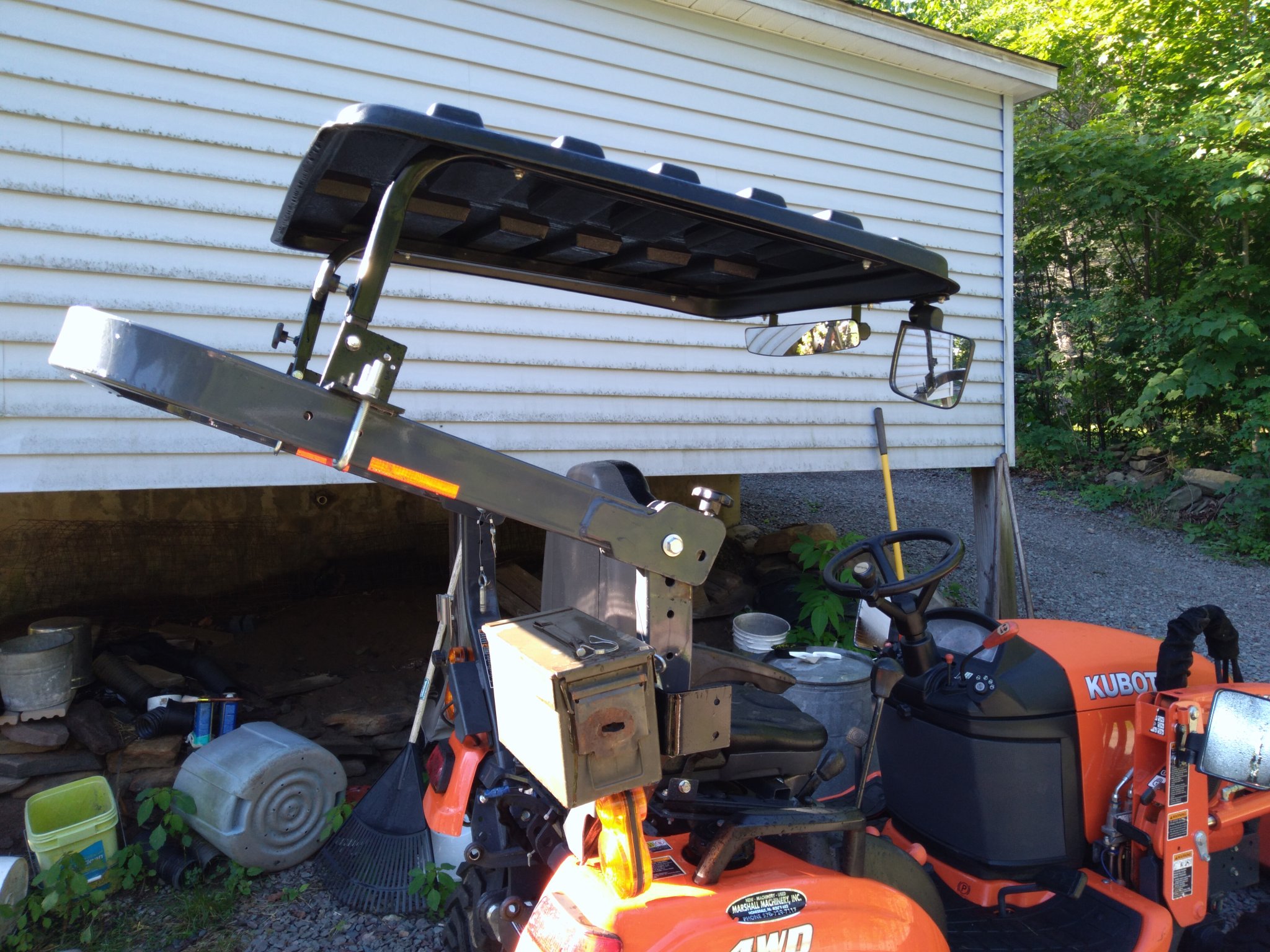

Well I wouldn't do it! Two knobs and the top comes right off. No tools required! When I need to get in the garage I just fold it down and insert two pins! FYI I drilled the two holes needed to do this!
Looks good. Also how is the ammo box mounted to the RPO.'s ?? Thanks,
Dave
