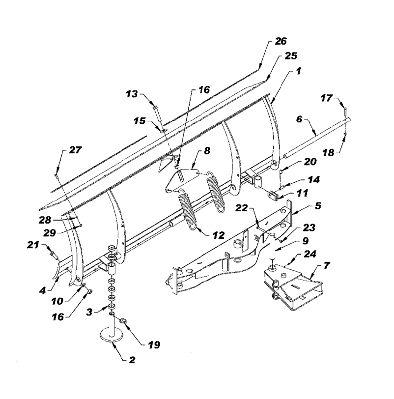

ALL the hits, even Messicks, show a V4290 to be a front mounted snow pusher blade,which is a totally different implement than '3PH rear blade'. OP mentions 'quick attach' which I also assume to mean SSQA,so isn't this really a front mounted blade ??

As GreensvilleJay mentioned I think this is a front mounted snow plow but I am not assuming the quick attach is a SSQA for loader. When I google I come up with picture of a quick attach much like the style used for mounting a snowblower to a BX machine. A lot of the hits for this snowplow looks as if the most common use is on Kubota's line of UTV's.

Just picked up a 6 foot back blade for my 1880. Lifts fine. Will see how it does this winter. If it becomes problematic, I’ll trim it down to five feet. Did test it out on my gravel driveway without any issues. Have a 5 footer that works good but the bottom pins are too narrow for my 3 point quick attach. Try it for now. adjust if it doesn’t work. If Kens posting of the schematic is correct, looks to be a front mount. May be a bit heavy for the loader. If it’s possible, maybe put a 3 point on it and use it pushing snow backwards and keep your front bucket on to pile the snow. Good luck.
