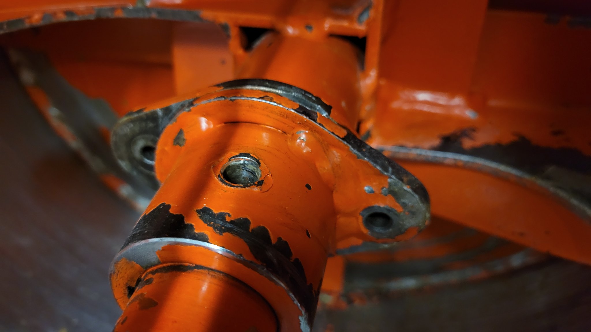

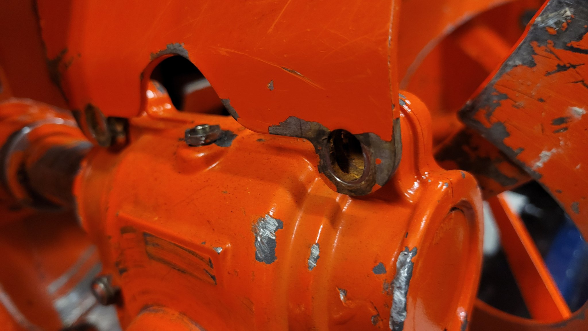

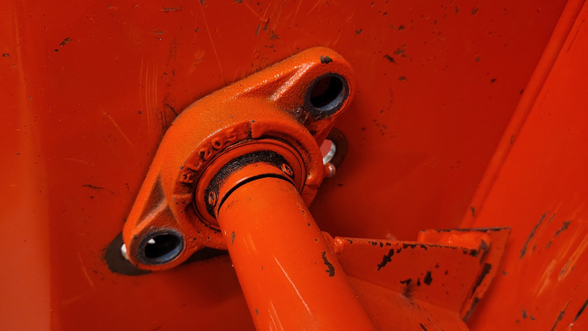

I snapped a fan shear pin at the end of the snow season and didn't even know it. I was still able to blow snow. As you can see in one of the pics, the holes for the shear pin are opposite one another and will not move. The fan should rotate freely with the shear pin gone but it doesn't. I am thinking that maybe a piece of the old shear pin has it jammed up. So I figured I would just remove the whole assembly to repair it. I removed the bolts holding the bearing retainer at the end of each auger and the bolts holding the front center gear box and I can not pull the assembly out. Am I am missing anything? Do I need to drain the oil in the rear gear box and take that apart to allow the assembly to pull out?

wedge the fan securely with wooden blocks then use pipe wrench to rotate shaft to align the 2 pieces ?
28,971
5,317

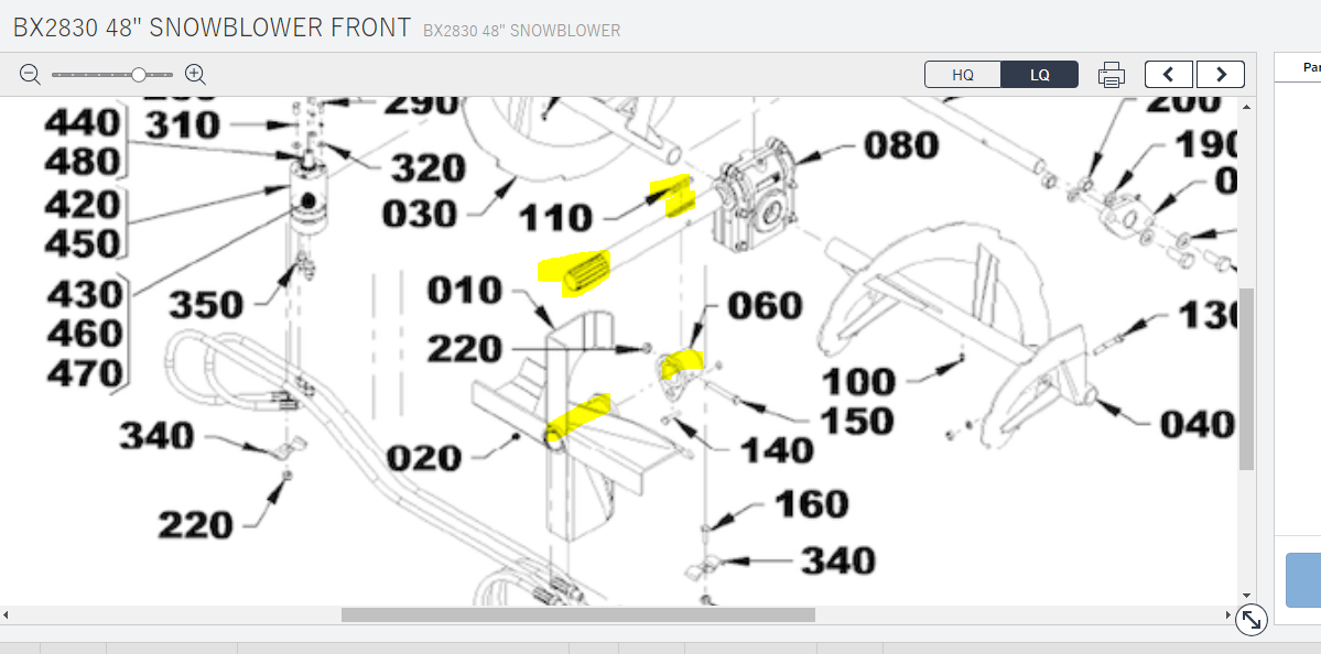

You have to remove the allen set screws on the back bearing.
Then the whole assembly will come out.
If the shear pin is out and the hole doesn't line up then you have also sheared the key #110.
Your in for some work to get it apart!
