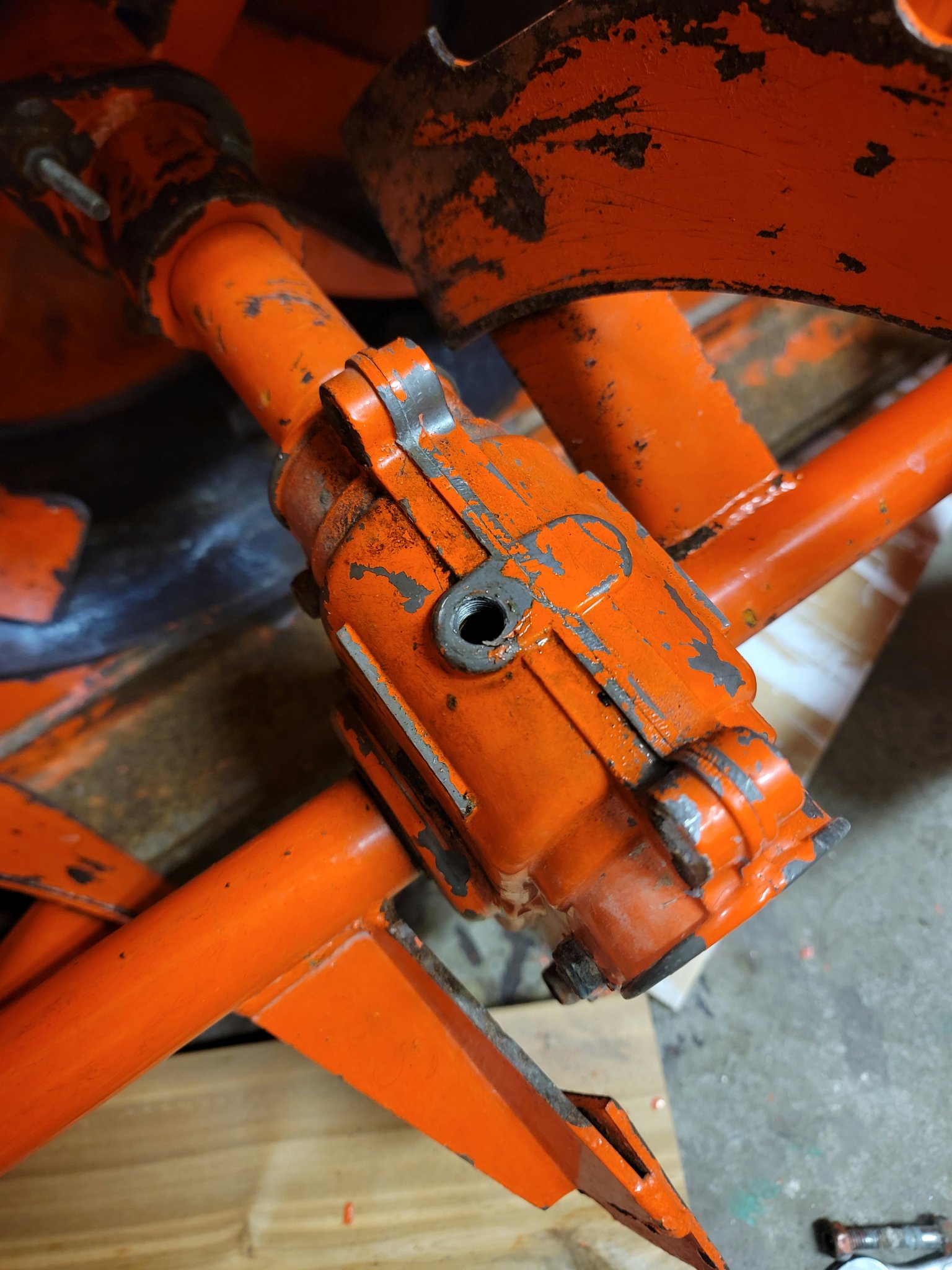

BX2755HD gear oil fill plug is seized. 11mm bolt, rusted solid. Used blower I dont think the gear oil was ever serviced
10,039
4,129
I know the vet cap on neighbour's blower (2816 ?) is REAL FRIGGIN TIGHT, probably due to unecessary Locktite. As others have said LOTS of heat to loosen the Locktite, then it'll come out.
if not, weld a nut onto it, let cool, then try again.
If it still doesn't come out, you're in for a real treat, TOTAL teardown as you'll have to DRILL it out.

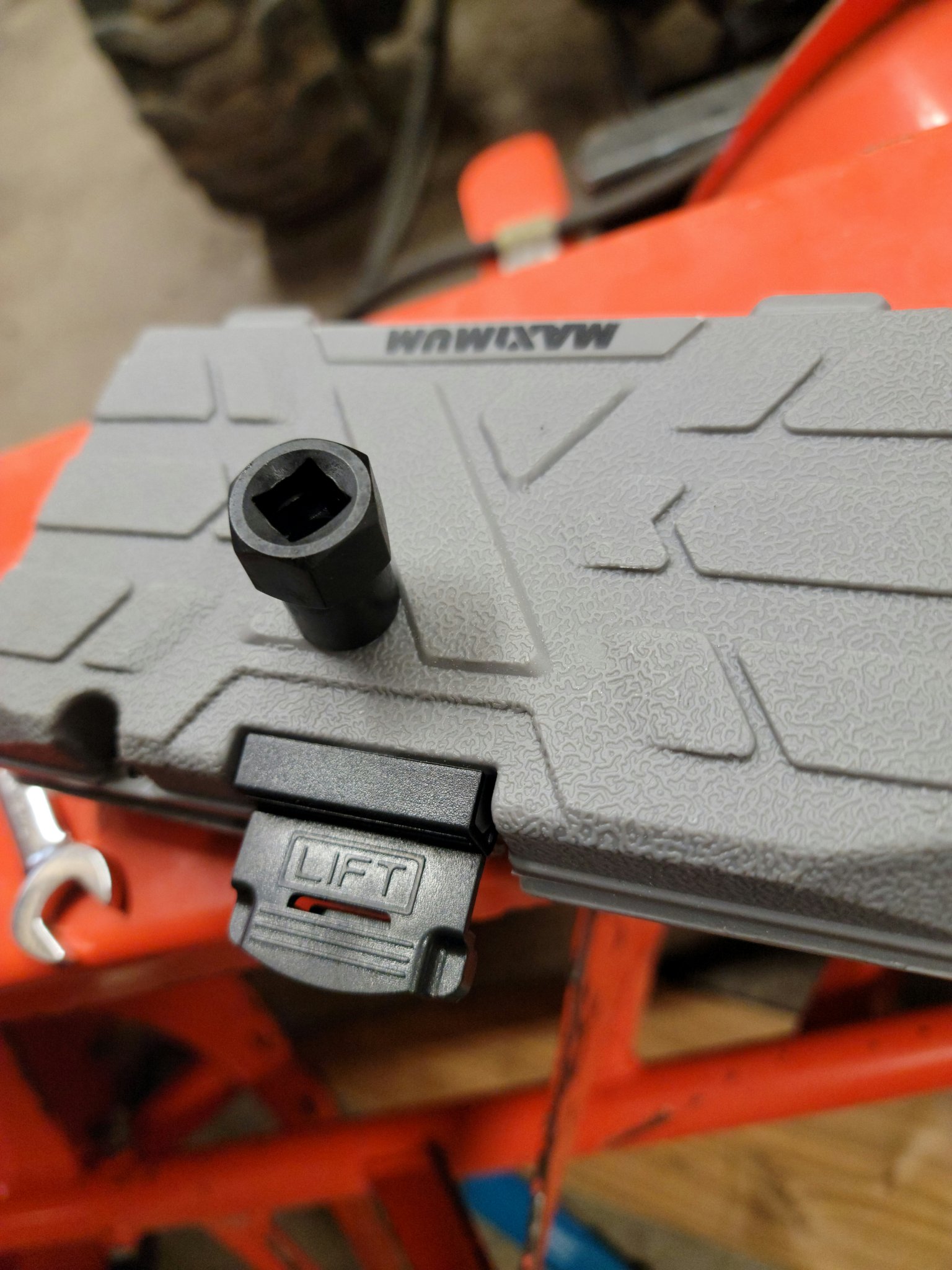

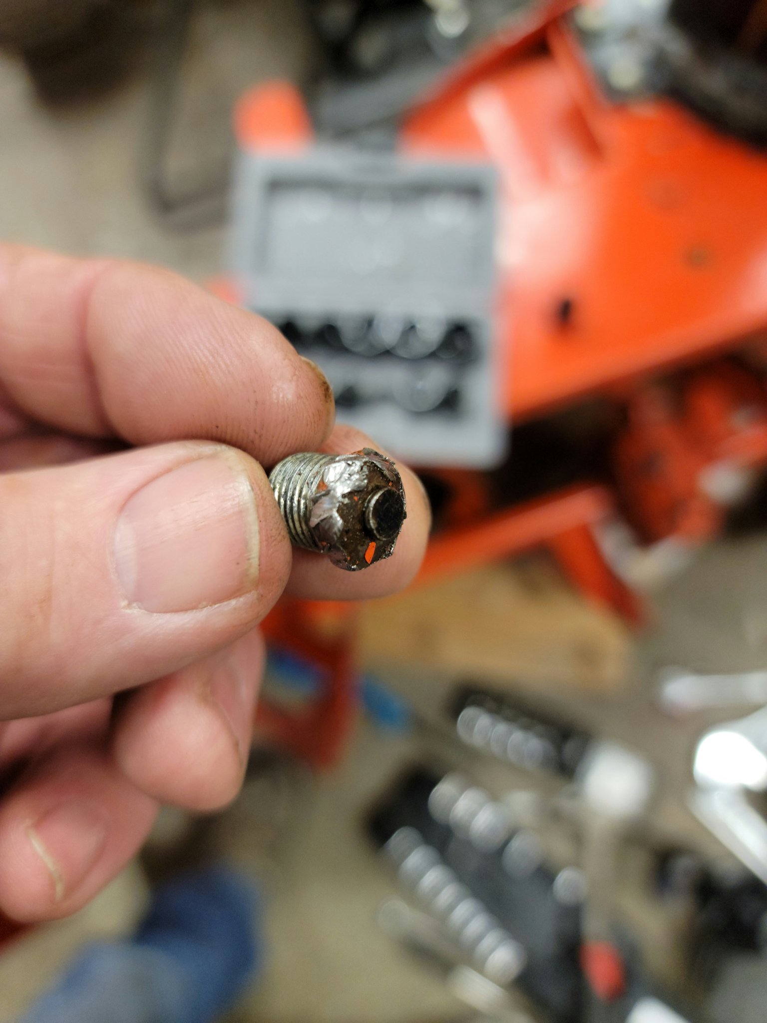

Got it free - three days of penetrating oil and impact driver and these "stripped bolt remover" sockets. It's out... now $37.00 for a new vent fill bolt... OUCH
Now into repairing the plastic cracked front support bracket.... I'll post some photos of this peice of crap.
Glad you were able to get it out. That sucker was pretty chewed up!!!

At this point, the hex of the vent is damaged. The hex is installed at the factory with Loctite and you must put heat on it to break the bond. I have a very expensive Snap-On stud remover ($350.00) that grabs onto studs and removes them without putting any side tension on the stud. Since you don't have access to that type of tool, I would use a Vice Grip Brand vice grip. There is a quality difference between the "made in China" tools and those made in the US and Canada. Don't worry about crushing it, just about getting it out. Use a plumber's acetylene torch for the heat. YOu will need to get it quite hot, but not hot enough to melt the aluminum gearbox case. The worst case is you will need to disassemble the front of the snowblower and take the gearbox to a machine shop to remove the vent if you don't feel comfortable attempting it yourself. Ruining the gearbox is something you don't want to do since a replacement is about $600 US. I have turned wrenches for over 70 years, and there are times I just rather pay someone else to do the work than mess it up myself. This might just be one of those times if I didn't have the correct tools to accomplish the task.

The snowblower is made by a company in Canada that makes them for all the tractor manufacturers. You can shop around, however, if the vent is still good, I would just put some pipe dope on the threads and put it back. You can check it by pulling up on the small tip and seeing if it still pulls out against the spring. If it does, no need to replace it. Why spend money on something that still works?

In RCW's post #11, it looks like the vent has been painted over ?
5,315
3,920
They are all painted over at the assembly plant. They used to just about dip the entire blower in paint, however, now they are using powder coat on almost all surfaces of the blower. The problem with powder coat is that once you have a chip in it, and the moisture gets under it, it will rust under the powder coating until it loses its bond and flakes off completely.
