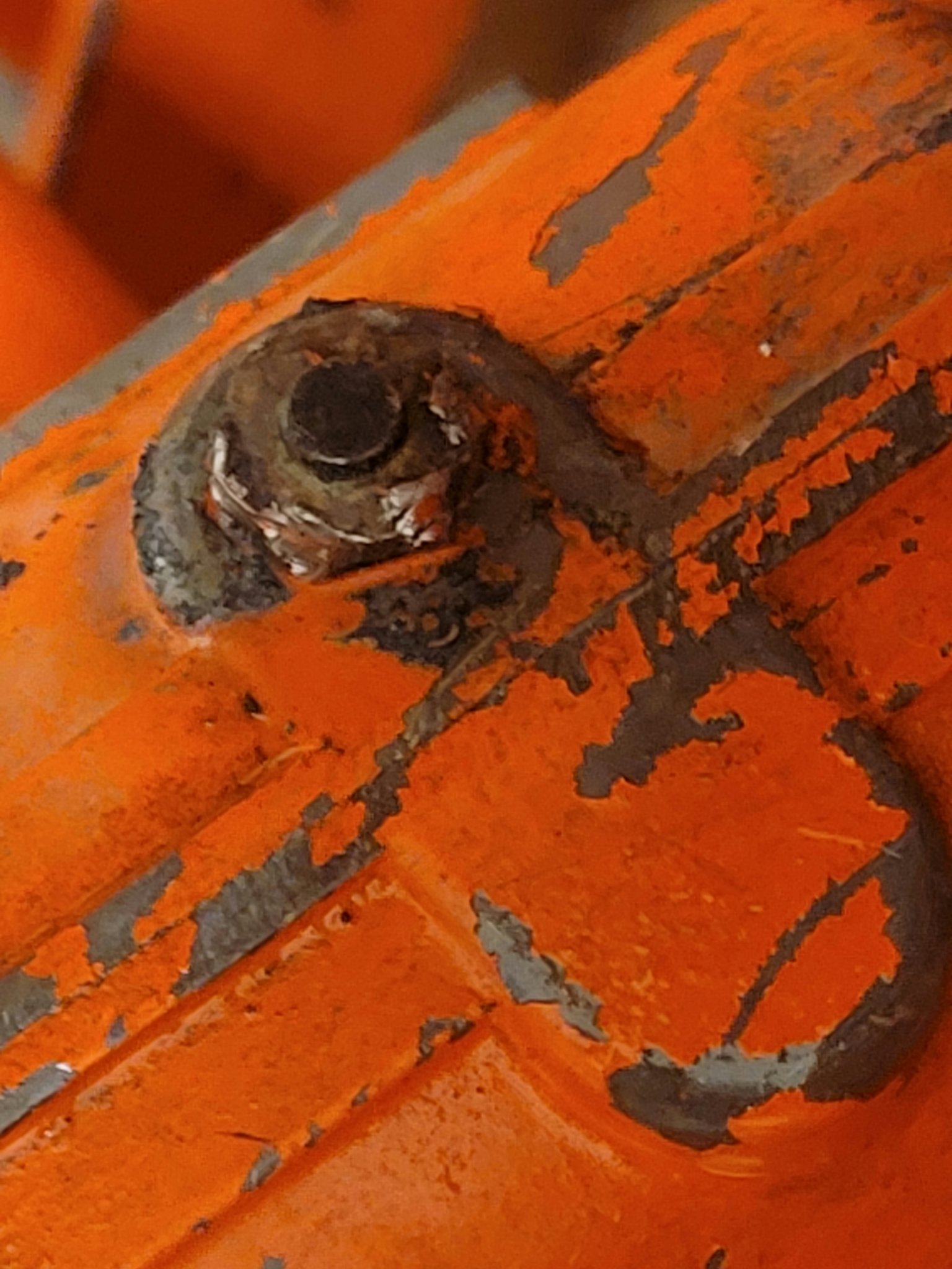

BX2755HD gear oil fill plug is seized. 11mm bolt, rusted solid. Used blower I dont think the gear oil was ever serviced

The 11 mm bolt is seized. It's now starting to strip. Any suggestions on how to get this to release. I've sprayed with oil, heated the shit out of it, it won't release

I’d like to think you figured that out prior to draining the oil. At least it looks like decent access to the area to sort it out.

Are you using a six point socket? The bolt diameter is 11 mm, not the head hex, correct?

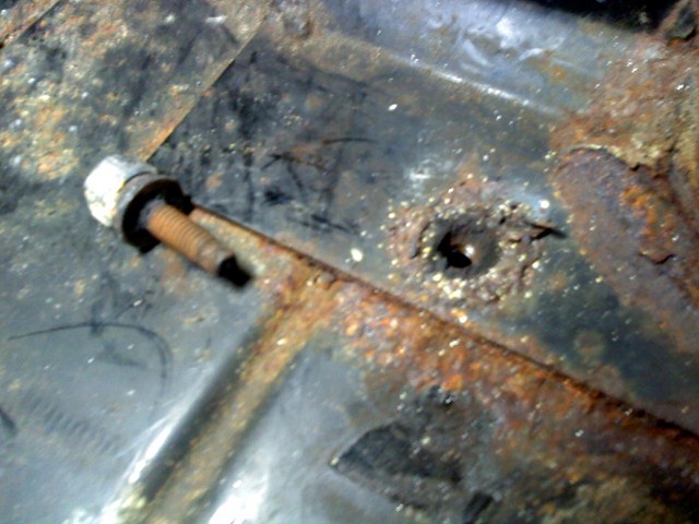

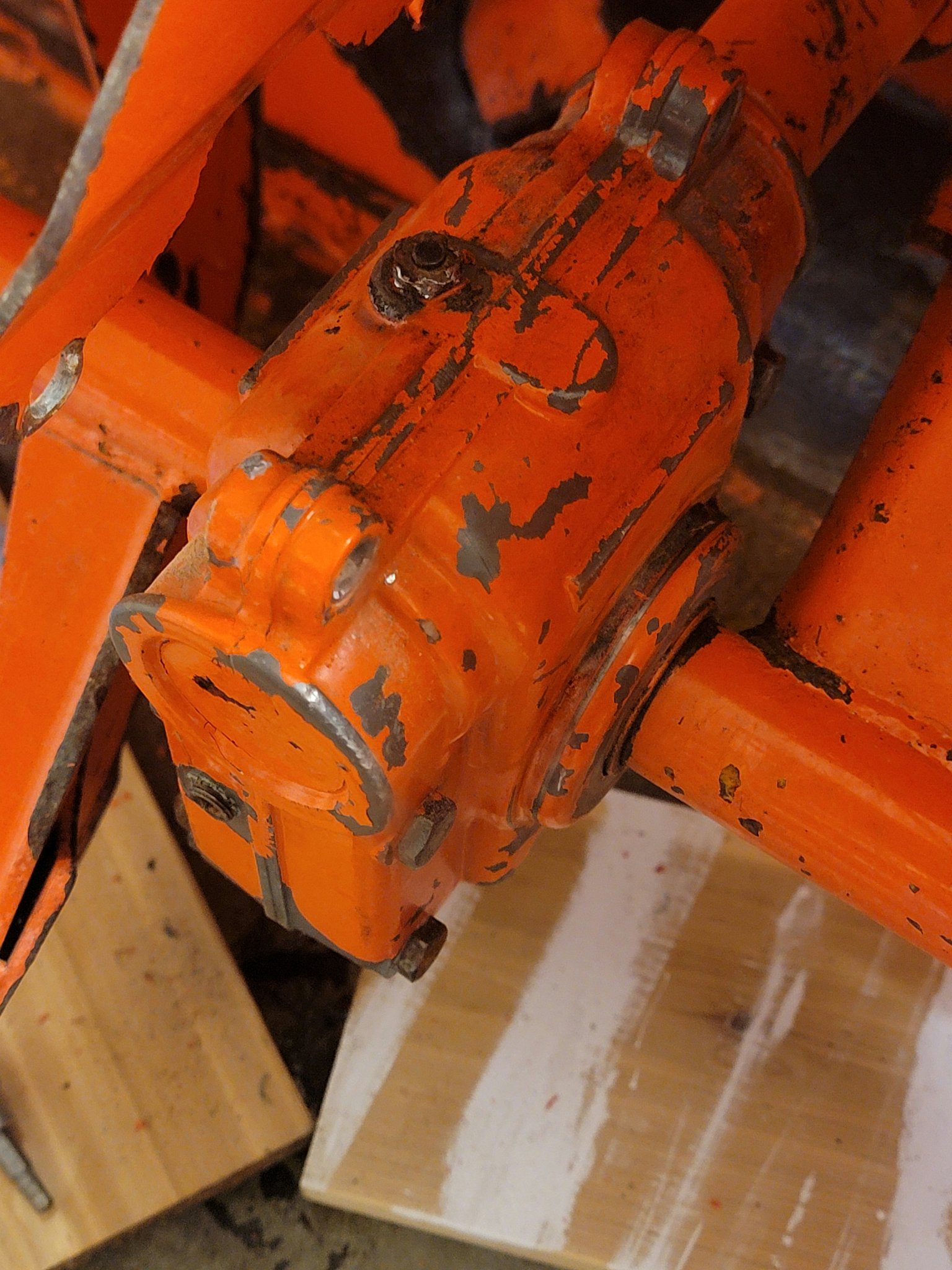

I think what you’re yanking is the vent, not the full.
Fill is the Allen set screw on the left side of the gearbox. Drain is a similar Allen screw on the bottom of the gearbox.
The Allen fill tells you when the gearbox is full.

I'm pretty sure that bolt on top is *not* the fill port. It looks like it is probably a bolt with locking nut for adjusting the worm gear clearance.
Oil fill will be the plug on the front of the gear box, fill to the bottom of the hole. The drain would be the plug on the right side at the bottom.

I looked at picture again- I think fill and drain might be the two hex head plugs on the right side of the gearbox, not Allen’s. Similar places my Allen’s are.
All may have locktite on them.
My apologies for the bad information. Check a parts diagram or operator manual. As I said, I’m guessing a little.

top one is the VENT and fill port
side one is 'I'm full',when oil comes out, please stop.
btm one is drain,yeah .remove to drain....
side and btm are probably NPT pipe plugs that ARE locktited in , for NO good reason
you'll need a lot of heat and patience to remove them
BTW if NPT, NOT metric, 3/16"(?) Allen key. Use a NEW one, tap it to be 100% sure it's FULLY in,vice grips on Alley key(tight), pray, then try giving a hard turn.

I just cut the spout of a quart 80w-90 gear oil jug small enough to fit in the hole. Squeeze it in.
Fill until it starts to come back out.
Change my gear oil every fall.

Regardless of what purpose that object on top serves, I assume that it would still have been removable and that the OP would s want to remove and replace it if possible.

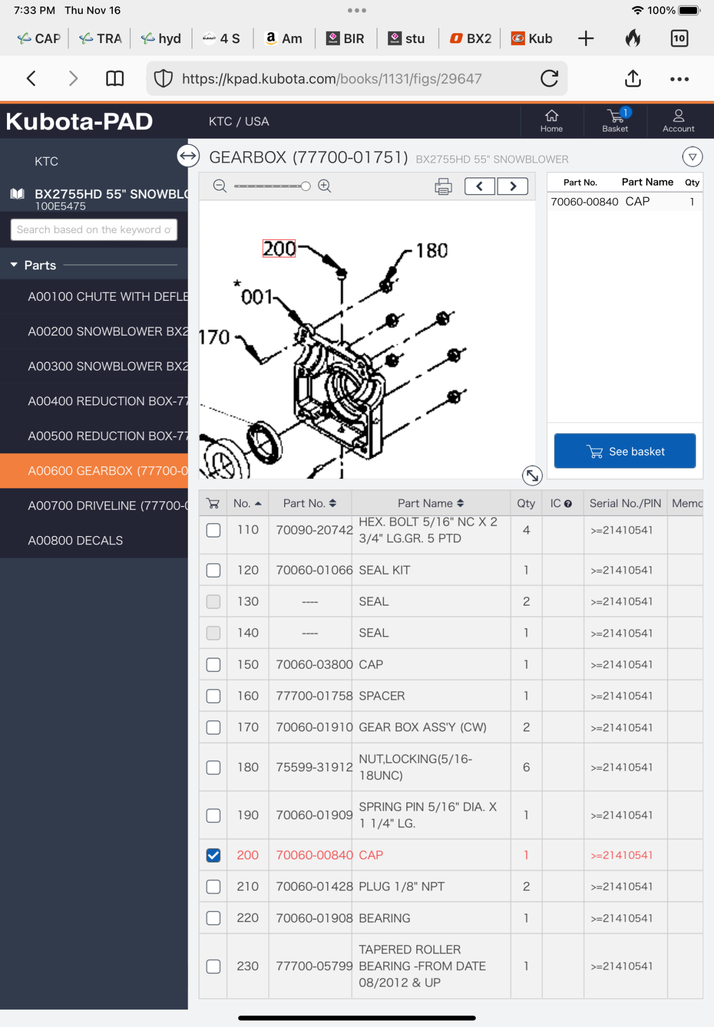

I went to https://apps.kubotausa.com/illustrated-parts/ and found this descriptive term for item 200 = CAP
If I was in the predicament that @Rob18530 is in here is how I would attempt to resolve this issue
Spray the heck out of the thing with your favorite good penetrating oil (PB Blaster, Kroil, Mouse Milk, …) and walk away.
Then order the part number 70060-00840 from the dealer. ( Messicks says it is a vent plug.)

Heat and crayons (or canning wax) work wonders.
Tough thing with that is you want to heat the hole.
Harder to do on a big chunk. Plus you don't want to damage seals.

Heat, cherry red if necessary. The case around the plug/vent, as you want expansion there, not the plug itself.
1,875
1,995
It's difficult to tell from your picks, but it appears (to me at least) you may not have actually damaged the actual vent itself, just the base of it.
I would open the "actual" fill port and blow air in there to test the vent, and if its still working,
"get some touch up paint, and never speak of this to anyone, ever again". :LOL:
