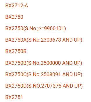

There's all of these different versions to choose from. Looks like the conversion started with serial number 2500000.
I have looked at the BX2750D parts diagrams and there is no indication that there are two different fans. As I have previously said, the BX2750 and the BX2750A use the same fan and then starting with the BX2750B, BX2750C, & BX2750D all use a different part number for the fan. I fail to understand why some continue to insist that there are 2 different versions of the BX2750D without being about to show conclusively any Kubota parts diagram to back up your assertion. The reason that I am so adamant about seeing the documentation is that next year someone reading this will confused by this misinformation.
To address this for those that have the BX2750/BX2750A type of fan on a BX2750 B, C, or D snowblower there is a very simple explanation. At some point, the original fan was damaged and replaced by the service facility with the earlier fan, and the "Tube & Shear Plate" Part # 70060-01287 to the snowblower, and added the appropriate hole in the shaft to accommodate the part so they could deliver the snowblower back to the customer quickly. Some other extenuating circumstances might have also come into play. and we have to remember, 10 or 15 years ago, parts delivery wasn't like it is today, where dealers are stocking just about every part to fix just about every snowblower that Kubota presently sells. What surprises me is that Kubota continues to inventory the 2 different part numbers instead of adding the hole in the shaft to the first design fan and then one number would service all the BX2750 series of snowblowers. In the case of the front wormgear box and shaft, it has been made backward compatible by having both holes in the shaft, one to accommodate the BX2750 and BX2750A fan, and the other hole to accommodate the BX2750B, C, and D fans. Please look at the pictures that I have posted for these details.

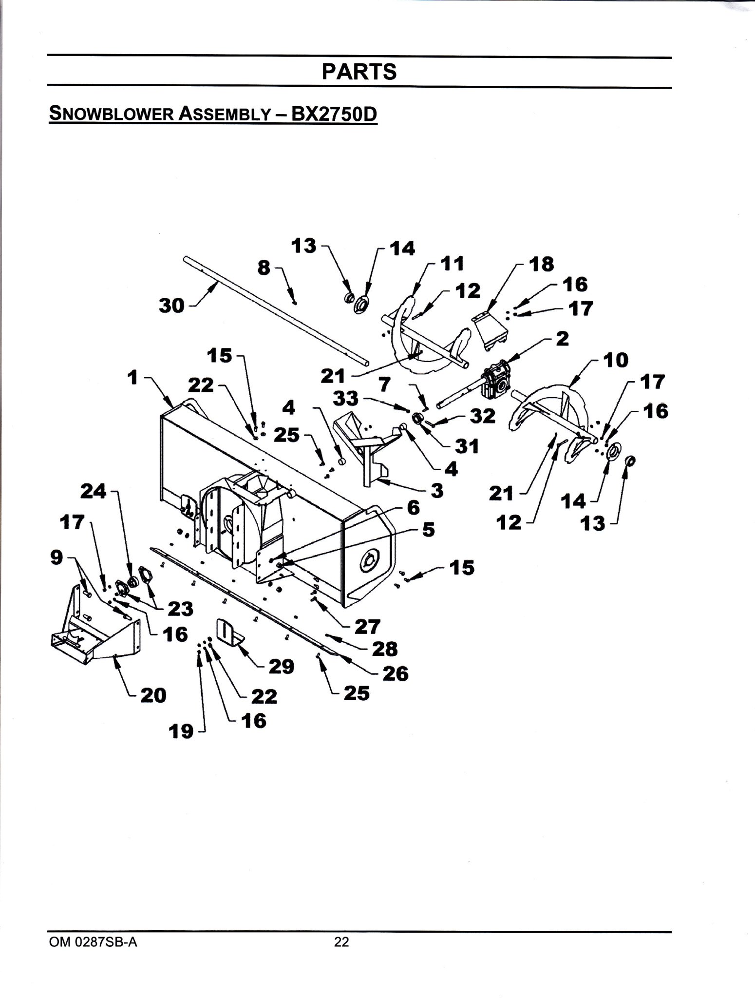

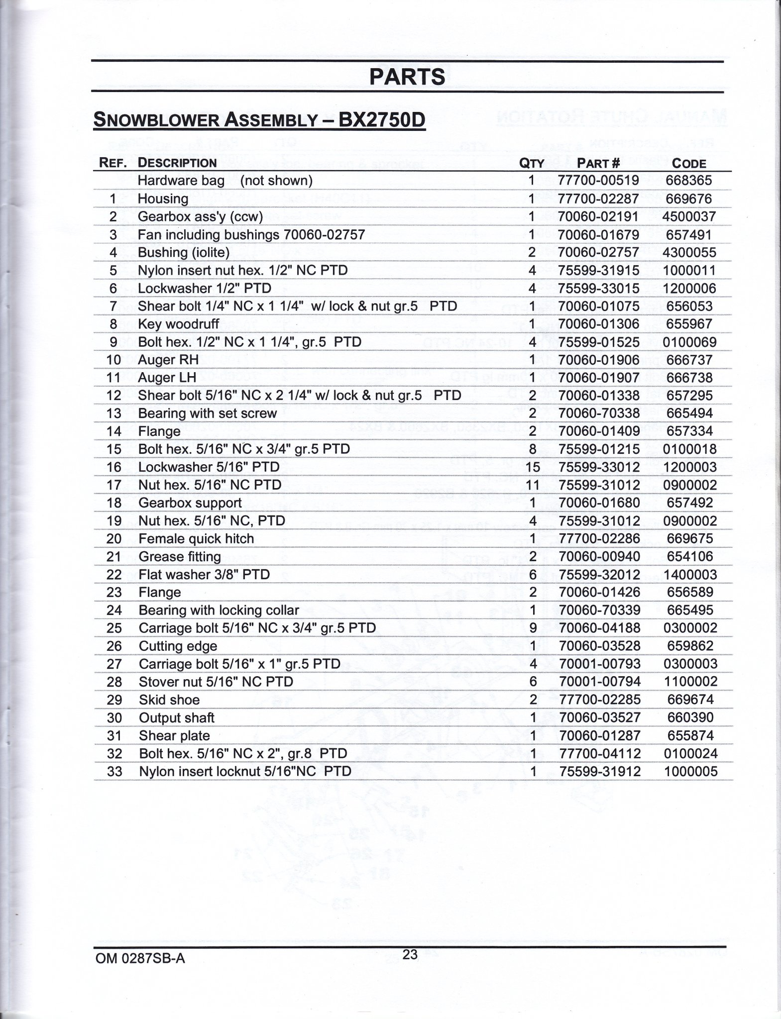

Ok, I scanned the manual, but the main pages are the expanded parts of the blower assembly, pages 22 and 23. Not sure if I can upload the manual here, but here are the images of pages 22 and 23. Note that part 31 is the newer shear plate, held in place on the shaft with a standard Gr8 bolt (not a shear bolt). The fan then has a matching face to the shear plate and a Gr5 bolt (#7) as the shear pin. I notice that the main drive shaft part numbers are the same between designs, so "maybe" one could modify the old shear system to the new one by obtaining the shear plate and a new fan (and whatever bushings) ??

It is now obvious that we are dealing with products sold in 2 different countries. The US versions of these snowblowers don't have a breakdown of the serial numbers. I just checked the shear bolt part number (77700-04112) item #32, the Messicks dot com website doesn't even list this part for the BX2750D snowblower. This adds a whole new dynamic to questions that are asked about snowblowers that are made in Canada and sold in the US. I would think that a BX2750D would be the same in both countries. This situation reminds me of the automobiles that were manufactured in Canada and sold in the US where the same model car was also manufactured in the US. It was a repair nightmare since the parts were not the same because they were manufactured in Canada for Canadian production and sold in both countries. Thanks for updating the thread and we all have learned something from this for the future.
