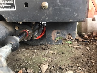

Thanks so much for the info I am quite new when it comes to owning a diesel tractor. I would like to pick your brain again for another issue.
I have the quick hitch bracket(2751) with the snowblower for the 2750D. I however do not have the 2752 mid PTO bracket. The bracket on the front of my tractor is shown on the picture below but I am worried that when I take the bucket off and try to install the quick hitch there aren't the two holes required for both pins.
I am guessing this is where the 2752 mid PTO bracket comes in handy? Any help would be appreciated.

What model tractor are you attempting to install the BX2750 snow blower on? The BX2750, including all the sub models, A, B, C, D, etc. use a Quick Hitch. I am not certain of the model number, and doing a quick search on the Messick website, I found a hitch diagram that is similar, if not the same as the one that I have on my BX22. It is BX2711, and this is for installing a snow blade. If you want to use this hitch with a snow blower, you have to install the drive parts to this hitch that connect the front PTO splined shaft to the hitch. In short, you will need a driveshaft, and the intermediate parts that mount onto the quick hitch, and the blower shaft mount to it. Here is a video that will help you to understand the installation.
