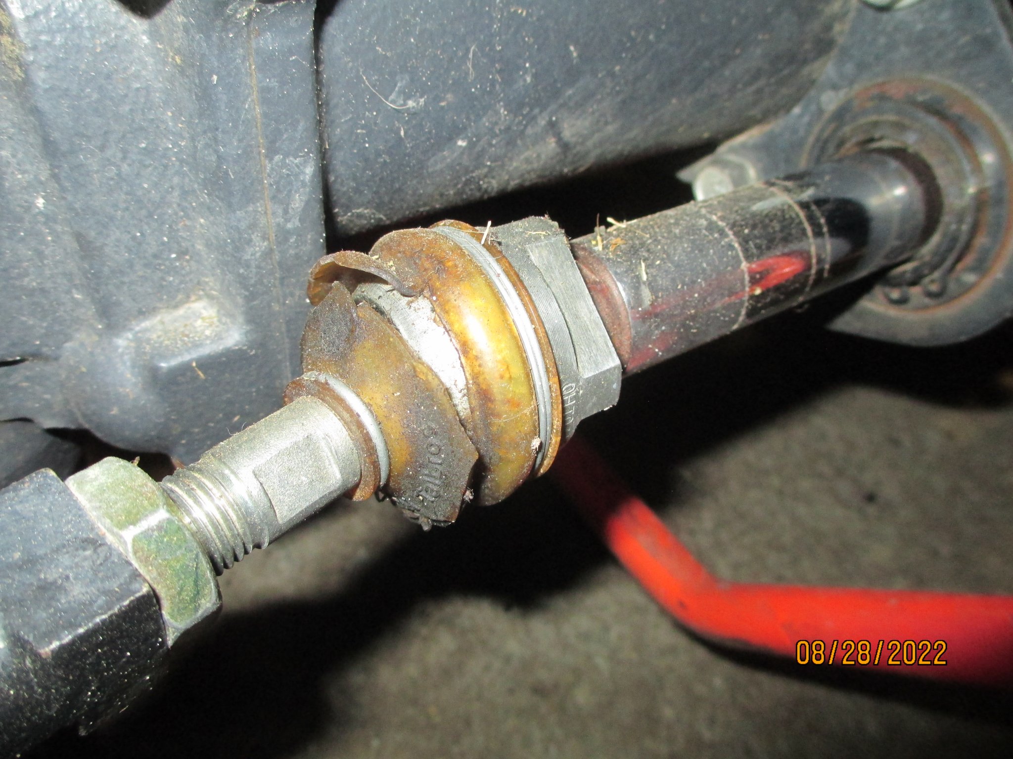

3. Torn inner ball joint cover - one of the inner ball joint covers is torn. Kubota parts would be a new inner ball joint. I think I saw a youtube video of replacement of just the covers/boots. I don't see those listed on the Kubota parts site - are those available aftermarket?

Of course, I would fix any damage that I identified, such as what you have shown.

My BX2680 has less than 150 hours and both ball joint covers are toast. If you find
some please let me know where.

I bought silicone rubber replacement boots on eBay. My tractor had a torn boot at 80 hours, and I explain it away as Kubota using materials that are not rugged enough to hold up to brush poking at them. Take your choice from below. I bought mine from www.Polyboots.com . Yes, it takes a little longer to get them, but it was worth the wait. I bought spares for the future to hedge my bet, and because of that, I will probably never need them, or they will be lost when I do need them!

Congrats on the new (to you) tractor, that's a nice machine.
Engine oil (and Kubota filter): Whatever you put in will likely be there for another 200 hours; I would recommend 15-40 full synthetic (Delvac Extreme at Walmart is about $22/gal, very nice oil). I wouldn't advise using 5W-40, even though it wouldn't hurt (sure does get cold in upstate NY).
Front axle: Definitely drain & replace the fluid. Your choice of 80W-90 is probably fine, just make sure it's fully drained before refilling. Personally, I would install Kubota SUDT2.
I advise on using the SUDT2 because I would also recommend draining the HST completely, installing new Kubota filters (there's 2, they are different) and refilling with SUDT2. Yep, Kubota HST fluid is somewhat expensive, but it's probably the best replacement fluid for your new tractor.
If you find yourself ordering Kubota filters, grab a fuel filter too. I would advise on putting good diesel in the tank with algae treatment & possibly another treatment (Howe's is great) then run that tank through and change the fuel filter. If there's any problems in the fuel tank hopefully fresh treated fuel will address it sufficiently, after which you can change the fuel filter.
Looks like your'e all set with info on the ball joint issue, good luck and welcome to the forum!:)

You asked about a ball joint cover, and that is what I replied with places where to purchase them. I have no idea what you are talking about when you mention dye. Dusty
