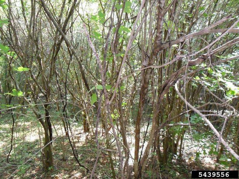

I bought a BX2680 with loader in August, starting to wonder if I went too small? My biggest issue is the power, or lack of it. Everything from brush cutting, to dragging a box blade, to digging. It just seems to me that the hydraulics on this thing are under powered. Should I have went to the L series? Don't get me wrong, I love having a tractor but I think I'm having buyer's remorse on this particular model. Would I gain any performance in those areas if I upgraded to an L2501?

Everything I'm running is 48", what was bought with the tractor. I generally run in low when I'm working. If I'm just moving back and forth transporting then I'll be in high, 4WD stays on for the most part. One example, I had some fill dirt delivered for some driveway repairs. I can get about a half of a load in the loader before it won't move and I have to back off some, tilt the bucket and go dump. It just feels a little like I'm missing power.

I'm wondering if the additional weight would be a benefit. I'm also trying to clear brush with this and find it difficult and tedious to remove it. It doesn't like uprooting things, just bends them over or breaks them and leaves annoying little stubs.
Piranha tooth bar added to the bucket would make short work of that brush. I remove a lot of brush like that with our BX.

Hard to tell from the photo but that brush might be a bit thick in diameter for your brush cutter.

re: I'm also trying to clear brush with this and find it difficult and tedious to remove it.
HOW are you trying to clear that 'brush' ? Picture may be deceiving but I see lots of 2-3" trees in the 'brush'
There's no way a smooth edged loader bucket will do that, wrong tool for the job. Backhoe will, though slow., but not on your machine
To 'uproot and move' what's in the picture you need weight,horsepower and proper blade ( think a small dozer ). Depending on the types of trees and the soil conditions, you may need LOTS of HP and weight.
Now 'can it be done' with just a 26hp loader....yes, but it wil be painfully slow, snail paced, glacier..... Will a pirhanna style bar help, yes but still slooooooow. better to invest the bar money into a miniexcavator rental if you want to clear the brush.
You've been asked good questions on your other tasks. Are your rear tires loaded, and are you spinning? Are they R4, industrial tread?
I'm trying to clear brush with my L35. I can tell you it depends on the soil type and condition and the tree/shrub variety. You can use your bucket on the small ones, you may need to go in with the bucket curled down and lowered maybe a foot before you get to the trunk, then curl it up as you hit the trunk to pry it out. It's a technique thing, the hard part for me is I can't see the edge of the bucket. A serrated type edge would work better also, I'm sure.
Pulling trees over is tough. If you don't cut it first, you're pulling the top over onto yourself and the tractor. If you do cut it, leave a tall stump so you have more leverage. Depending on the tree and soil, it may break off. I started wrapping a chain around them and pulling them up, using my fork frame. By rocking the tractor back and forth I've pulled pines up to 6", but you have to be careful to keep all four wheels on the ground. I just got a Brush Grubber HD to try to speed the chain wrapping step. It didn't work well for pulling out whole trees because the pivot point acts like a fulcrum and pries the teeth off when you pull the chain. It may work better if I cut the tops of the trees off first so it has a straight pull. And it may work ok if you're pulling stumps over and on crooked brush.
