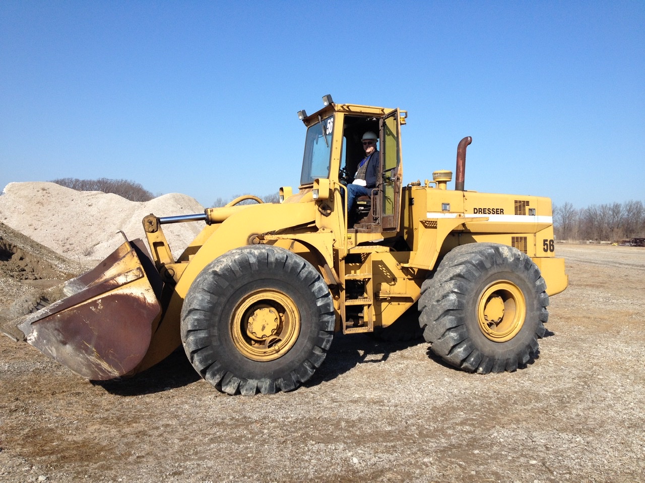

I am not too far behind you…although I don’t see myself getting another tractor soon unless I would do an about face and want a cab…I think eventually I’ll end up with a track loader.
A track loader is a wonderful thing!
Make sure you don't get one that is too small.
Then....make sure you don't buy one that is very cheap, but is all worn out!
