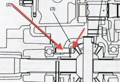

Thought you might like to see where it is in the differential case.
Follow arrow 2 just a little to the pin. Notice all the stuff that has to move to make that pin engage.
And it looks like pin 2 (long red arrow) has to fit into a hole in the differential gear (short red arrow). That would explain why it will go in at only certain positions. I usually have to try a bunch of times, with a slight move between tries.
I wonder how many holes are in the gear.
