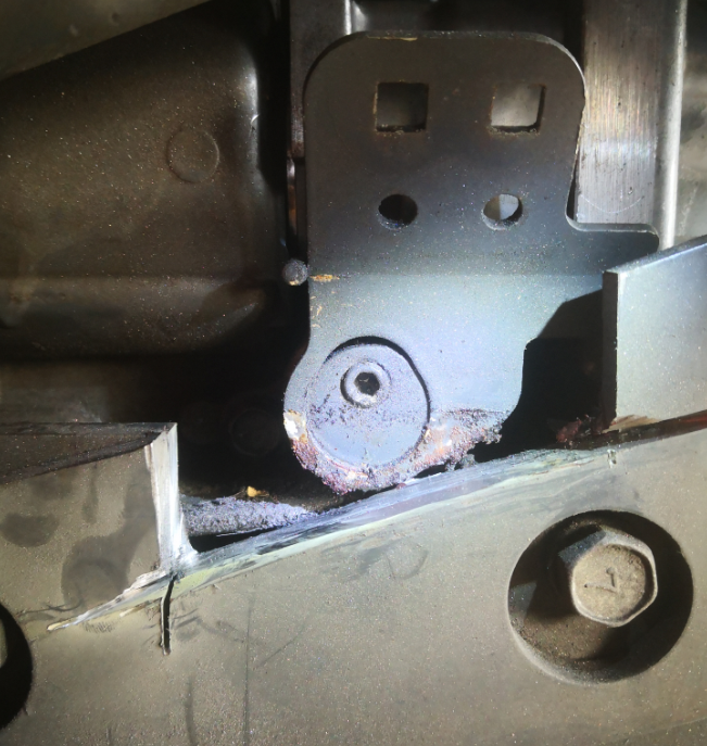

Sorry about leading you on a wild goose chase. So are you going to notch the frame to get the valve out?
NP! All input helps!... thank you the continued interest ... YES we are trying to get our hands on a Plasma Cutter... don't want to attempt with Blow Touch.

ok ...we look into the possibility just now!... it could work, that said we would need to strip the top section down to the fuel tank etc... to get enough depth with say a 4inch disk on a small angle grinder ... that could be a option...thanks
It is a lot more difficult getting that valve out on the backhoe tractors because of the frame on them for the backhoe. I suggest removing that frame and notching just the tractor frame to gain access. I have always used a 5" angle grinder to make the notch.
concur we assess the suggested approach...

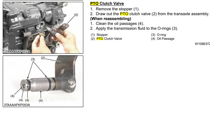

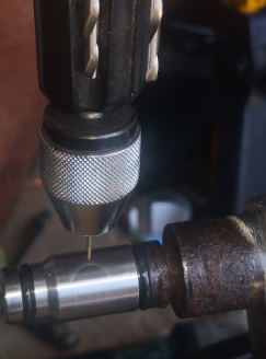

Progress!!! we now notch frame Fig6a, extracted valve Fig6b, drilled out 1mm hole it was partially blocked! Fig6c, replaced 2 new o-rings, PTO tests full operational again!, pressure @ the test port reading is now 64+-psi up from 32+-psi ...WSM (page 146) reference relief valve setting pressure (71.2 psi) Fig2-M16, hence we make it +-11% of the recommended value ... comments please ?

Did you clean all the oil passage holes? I could see that little one close to the o-ring being easy to miss.
