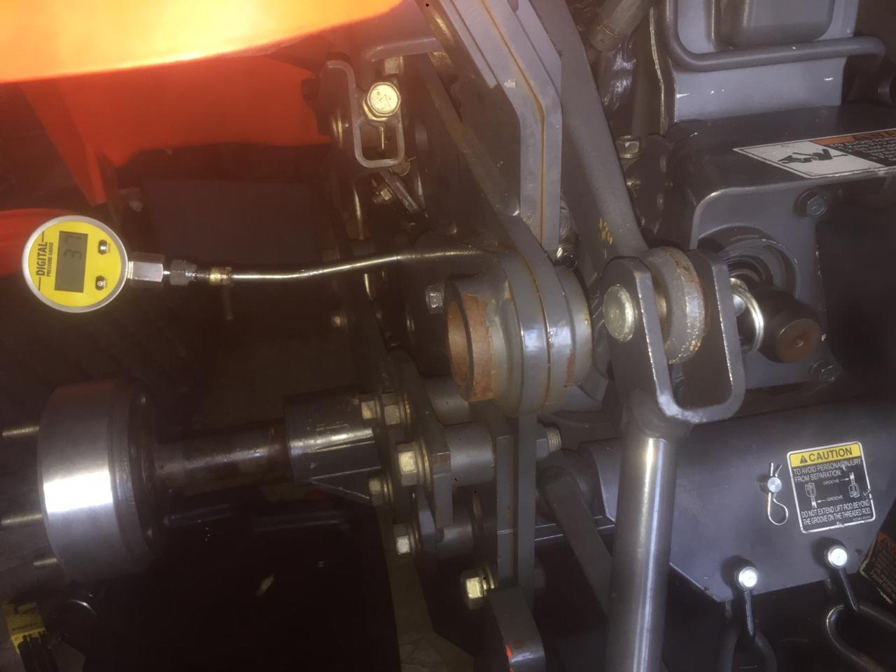

Yes but we are struggling to get our hands on a adopter "1/8" pipe nipple" :(.. any suggestion as to where we may purchase item!

Don't know about Jamaica, but a pipe nipple can be found in most hardware stores; like home depot, you don't need an 8" one, but you get the idea. Then you will need a coupler to go from 1/8" to whatever size your pressure gauge is.

I think the tube on a grease gun is 1/8" pipe. Make sure whatever you use is clean! Good luck.
we did not have much luck re finding a adopter solution today ... we aim to find a way around this tomorrow at some point, ... noted your suggestion, thanks for the continued input much appreciated !

That R1/8 is not a tapered pipe thread like NPT used in the US.
It is European and will require a sealing washer to seal it. It is also similar to BSPP THREAD that Jamaica may use from the British influence.
A 1/8 NPT pipe will screw into the hole but will mess the threads up so don’t use a pipe.
Swagelok makes adapters and sealing washers that will adapt that thread to other types like NPT see RS Adapter on page 6 of this link
Parker will have similar adapters I believe.

ok Noted thanks for info...

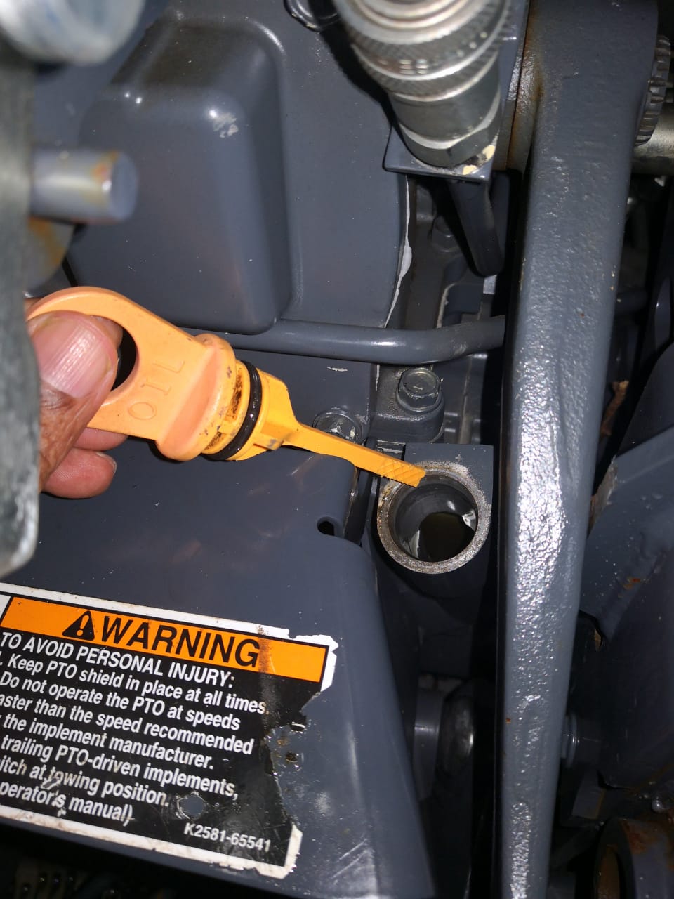

So the "grease gun pipe" to the rescue!...thanks to @PoTreeBoy ... a R1/8 adopter rig was made Fig5... to enable a pto clutch downstream pressure test... reading showed 37 PSI with oil temp @35c Fig5a 80% below WHM recommended level! ...so what do we now ?? also while observing oil in the main tank see bubbles we are seeing when we engage the pto Fig5b ...is this normal ?....

Yes...when its disengaged the pressure is 0 psi....
Surprisingly low pressure when engaged.
I am wondering if there is any flow.
Think about doing a test with the port open and no gauge and just cranking the engine but not letting it start to see if there is a flow of oil coming out.
Either there is an internal leak getting rid of the pressure before it can build up to engage the pto or there is actually next to zero flow

Hmm. Figure 5b is looking in the R1/8 port, right? If it wasn't so involved to pull the valve, I'd still recommend that. I can think of scenarios where that frothy oil is causing your problem and it can't be helping the other systems on the tractor. It even supplies the charge to the hst. That air leak needs to be fixed and I'd do that first, hoping that it might fix the PTO issue. I'd verify that air is getting in the system - maybe pull a loader hose. If it's foamy, there must be a leak in the pump suction. Check and repair/replace filter, orings and hoses to fix the leak. Then repeat the pressure test. If it's still low, notch the frame and clean the valve. Good luck.
PoTreeBoy sorry some how miss this response...NO Figure 5b is NOT inside the R1/8 port... the image is from the inside of the main oil reservoir ...through the dipstick port hole! see Fig5c ...
Dave
ok we though the same so we took off the pressure gauge and surely the oil did not gush out! ...it only slowly steamed out @ the same kind of low pressure the readings are giving! ...also note we rechecked the upstream pressure at the steering wheel controller to ensure there was no change an we are still getting 200PSI... we are confused! ...i am thinking the valve has some blockage... but if so why only when the oil gets HOT! ...as the PTO still works fine at full "toque" when the oils is cold! ...just don't get it!!!
