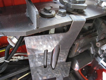

Looking up under my Bx this past week, I saw a FACTORY plate that seems to be well placed to stop sticks and what not from getting in there and breaking the fan blades.......must be new on 2013 models and newer !
Glad I have it!:D
Glad I have it!:D
I have the same exact plate underneath:rolleyes: The blades got cleaned off now all I have is a plastic hub. I've read on the forums some cost of $600 to replace an $8 part b/c all the tins have to come off and the tractor has to be split to swap it out. :eek:
I run over all kinds of sticks and what not too, I leave my MMM on just in case! Seems like Kubota got smart after all those blades got busted!
