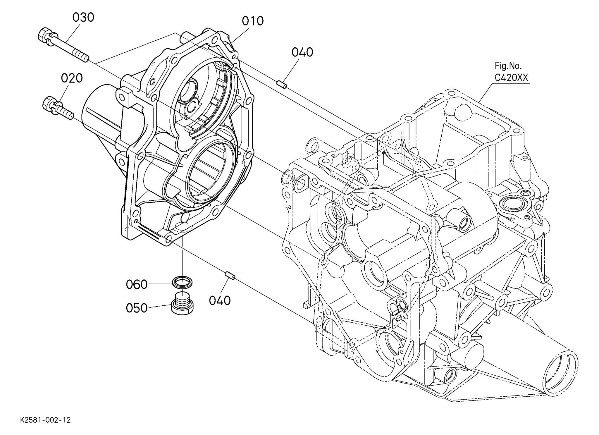

Is #50,i the attached drawing, the drain plug where the balls came out ? if so, hard to see how HST parts could get there
Lots of bearings in the diff case though.
If the 'spare' rear end is complete, maybe swap them and tractor's 'up and running' THEN you can slowly go through the busted unit on your bench ?
I will double check, but I believe it was the furthest drain plug to the rear of the tractor that they came out of.

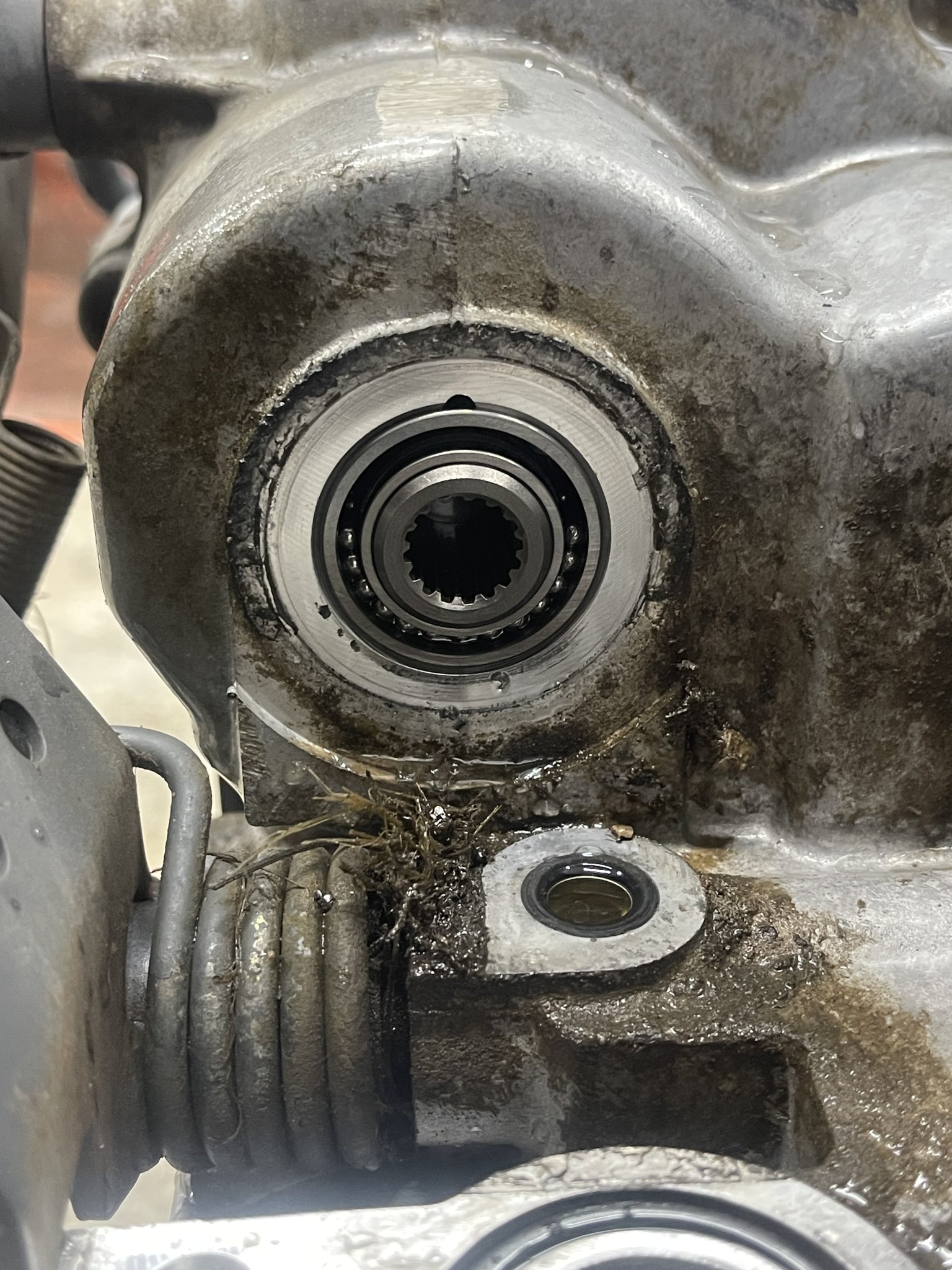

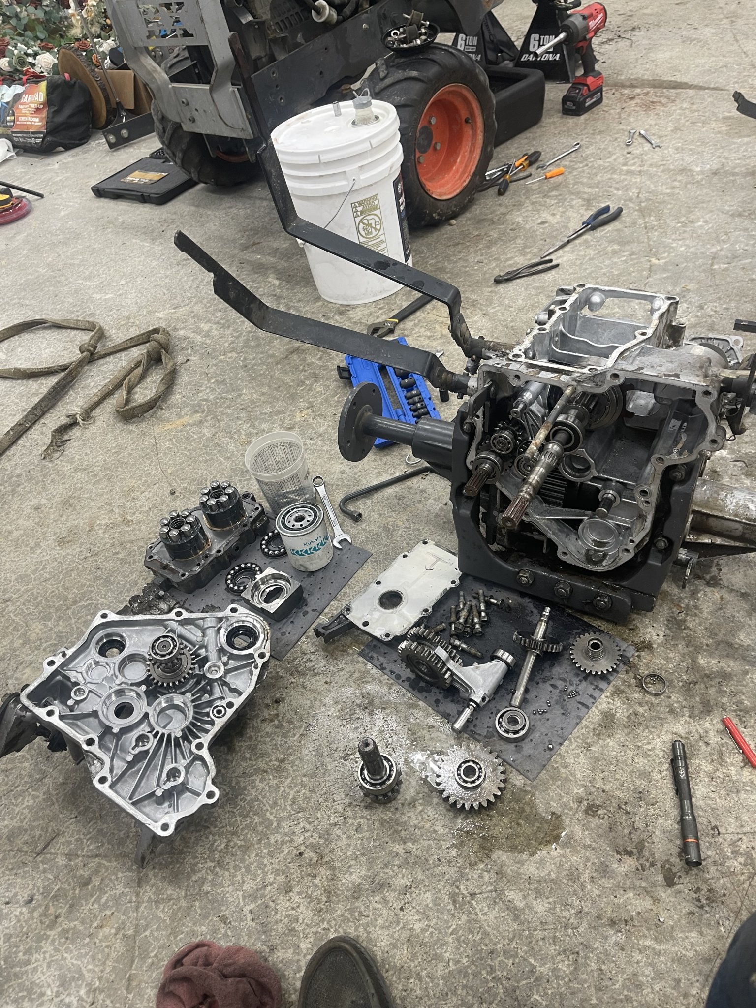

so I pulled the hst and rear case apart, found some bearings that came apart, 2 on the idle shaft where the hydraulic pump shaft goes through the housing. Surprisingly I have not found any gears that looked damaged. Looked everything over real good and flushed out the case. Just ordered new bearings. Hopefully this will fix my issue.

curious..can you post the bearing numbers from the drawing? that second picture, bearing missing balls is well '''one for the books'', and it'd be interesting to hear how it failed !!
