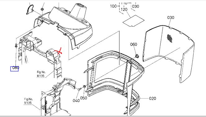

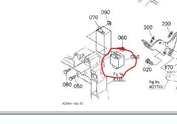

GlueGuy New member Equipment 2018 BX23S, 3PH, Back Blade, Rake, 18ft Trailer Apr 4, 2011 25 0 1 Newport, North Carolina May 13, 2019 #1 I can't find out where the key stop timer is located on my BX24. Help is appreciated!
North Idaho Wolfman Moderator Staff member Lifetime Member Equipment L3450DT-GST, Woods FEL, B7100 HSD, FEL, 60" SB, 743 Bobcat with V2203, and more Jun 9, 2013 28,713 5,129 113 Sandpoint, ID May 13, 2019 #2 It's under the dash on the center pillar. Pull the panel under the dash and you should be able to see it. Attachments BX24D stop Timer location.JPG 20.7 KB Views: 217 BX24D stop Timer location1.JPG 51.2 KB Views: 211
