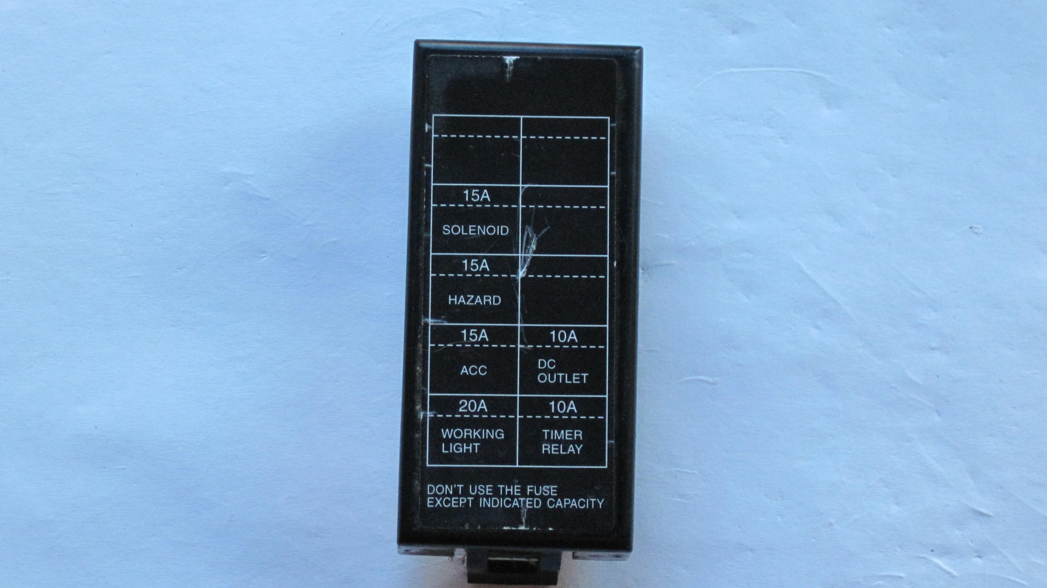

Today's temps mid 50s. Several days ago, gave "OJ" a bubbly bath. Tractor both started, operated fine. Been off a couple days. Installed the battery today. Cranks fine, no start. With my hearing being what it is unable to hear the fuel pump, however able to put my hand on it & seems to be vibrating feels like pumping. The start solenoid cycles on & off with the key. All the electricals (lighting) at the dash, body, all doing their thing. I did manage to find the fuse box just under the dash each fuse pulled, tested fine, reinstalled. I've no idea if any other fuse locations under the hood area? The safety switches around / under the seat I cycled those plungers as well. With the day drawing to a close just too dark for me to investigate further. Just for the hell of it called a "K" dealership (Townline). Talked of having them make a field trip as one of their flyers just happen to come via snail mail. They're just about 50 miles away, would involve 2 trips. 1 to come preform evaluation, 2nd trip to perform any repairs / parts replacements. The cost for each trip alone $400.00. I'm surely open to other ideas, areas of the tractor to look into. Frustrates me to no end, when I used to perform such during my RR career, yet now, lucky if able to see & open a damned medicine bottle.

The OPC if that's the under-seat plunger, for a quick test at the time with the plunger extended eng wouldn't crank. With the plunger retracted (by sitting or maually holding the plunger in) eng would once again crank normally. The stop solenoid under the hood when energized its arm would extend while in the glow plug position. Once deenergized after a few secs would retract, which appears to be functioning properly, least going by the many YT vids advising to watch the solenoid for little to no movement being the issue during the startup procedure. The arm/plunger on mine really travels along with loud click each direction energized / deenergized. Anyways. I'll give unplugging the solenoid a try come daylight.

brrr... It's cold out there. Disconnecting the stop solenoid produced same results, no start. My mother's intuition seems to be leading to a failed fuel pump itself. I can't hear it percolating, though, that could be due to my loss of hearing. Hand on the pump itself can feel it doing something. I want to say in the past (just days ago) I could hear it rapidly ticking away during the glow plug & start positions. With my O'l mem banks could just be in my O'l head. I had hoped to come across a fuse for the pump itself, didn't find one in the fuse panel itself. Largest there was a lone 20amp for "Working Light". I replaced all the fuses with new, each haven been tested, both new / old good. I've yet to notice / find other fuses / relays about the tractor.
