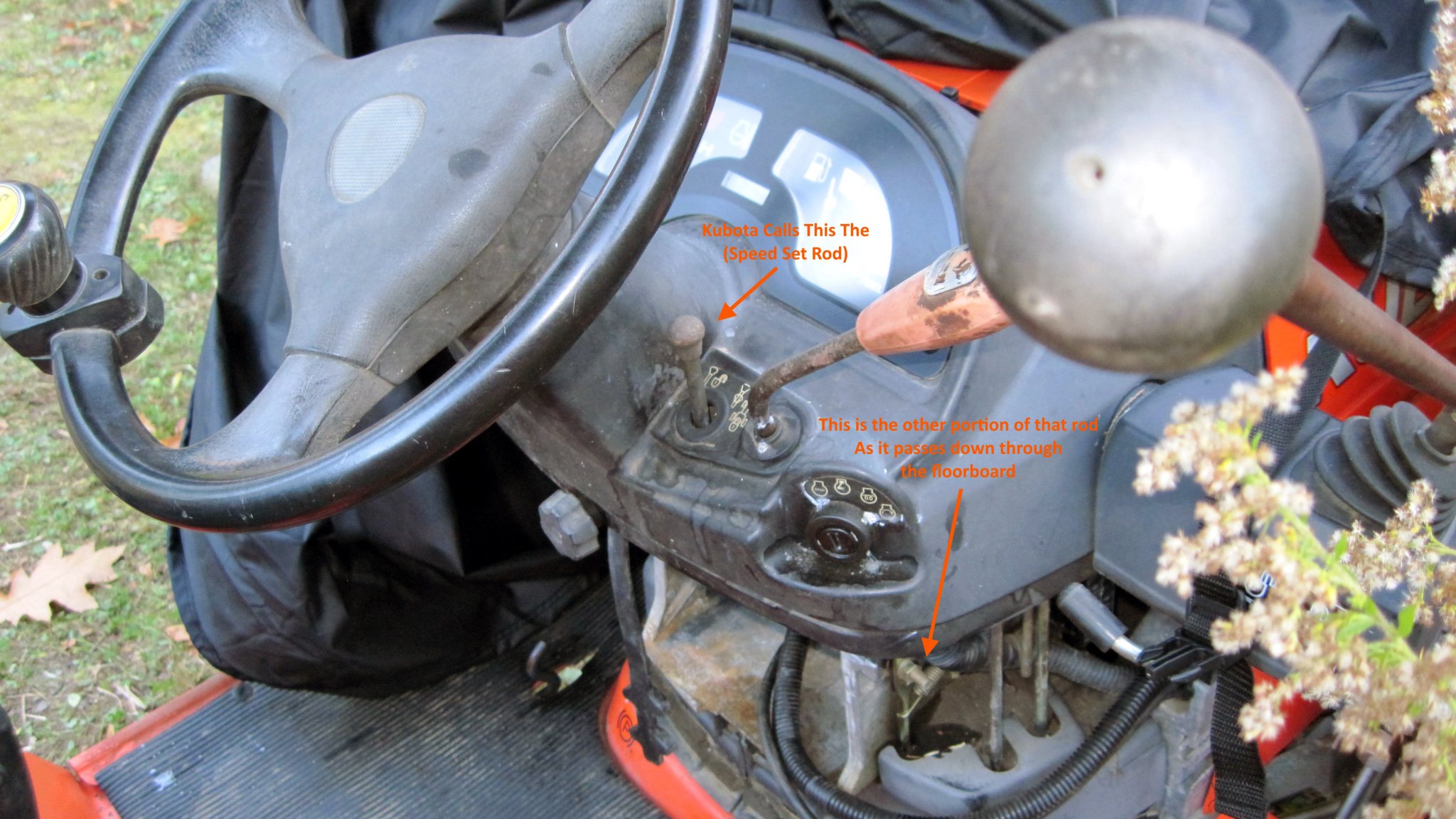

Well, I finally got the tractor going, seems better than ever, what time I've had it. It appears haven washed away the crud just under the floorboard allowed the "speed set rod" to move just enough to cause a mismatch with the HST pedal, &, not allowing the rod to drop into the little indent where it should set till either moved via the dash or HST pedal moved around. I also took it all apart straitened the rod for a better fit, now drops into the indent as it should, also released properly. This also allowed the fuel pump to start pumping like no tomorrow, with its auditable rapid clicking in power / glow plug / start positions that I was semi-sure heard before washing days ago. Tractor also fires right up without use of the glow plugs, though, today warmed to roughly 55/56F. With a fuel pump haven been ordered I may or may not install, perhaps, in the spring, along with other normal maint. Sheriff will still be here next week for the forced delivery to the Dr.

Not sure what a "speed set rod" is, but glad the story has a happy ending.
I went back out quickly snapped a shot, didn't crawl to the underside, just too pooped to get down there again for the day.
Thanks for taking the time for posting that photo. I don’t believe there’s a rod like that on either of my tractors, the BX 2200 or the B 2910.
