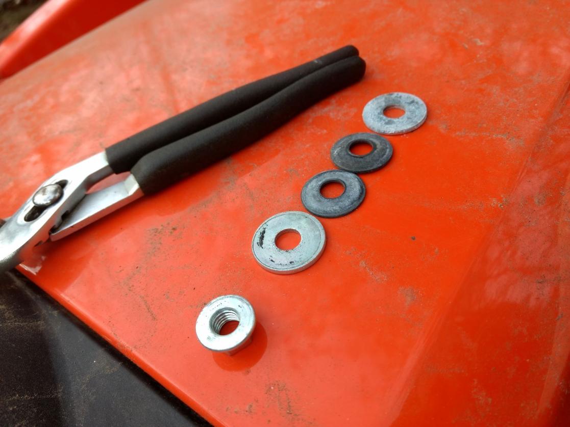

Howling
BX2370
Feb 5, 2016
217
10
Ayer, MA
On my BX2370-1 there is washer stack above the nuts. The cupped/rubber washers stack up to make spring.
How much you compress the washers with the first nut adjusts the friction holding the throttle in place. The second nut just locks to first to keep them from vibrating off.
Mine has M8 standard flange nuts.
