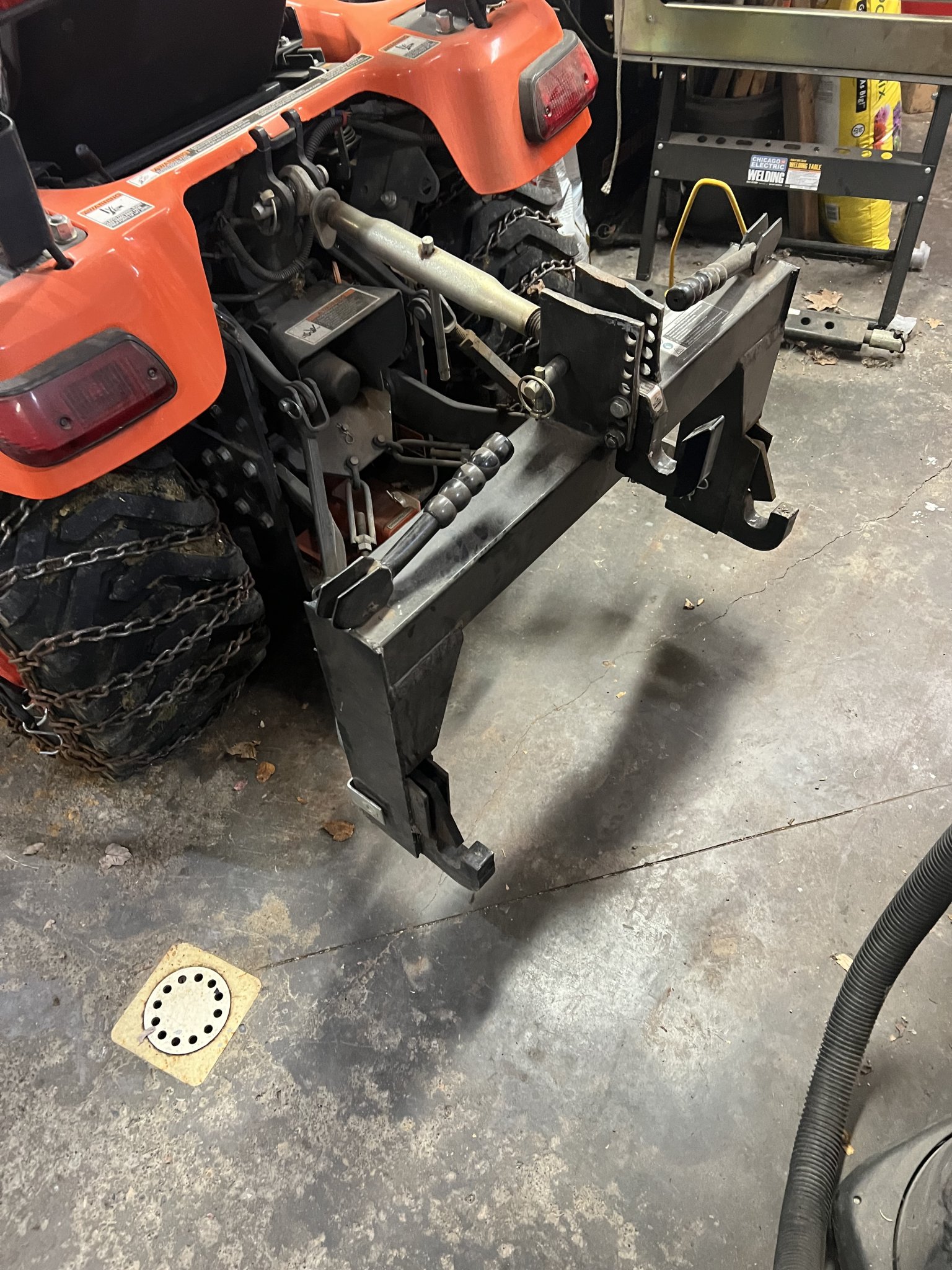

I have the mount and 10 suitcase weights, totalling 550 +/- Lbs. I'm thinking of making some "S" bracket hangers and welding them to the back of the mount. On the bottom, weld a piece of pipe to span the brackets so it drops into the BH ears for easy removal.
Thoughts?
I've also thought about welding pins to the mount and a couple pieces of angle to make it 3PH compatable. This is not necessarily of interest.

Neat idea.
I'd be concerned about the mount being close in tolerance to ensure unform loading on all four backhoe mounts.
Otherwise you might cause damage to one or more of the backhoe mounts, if that makes sense.
You seem to have the skills and ability to do that without an issue - - I might not.... ;)
Just Devil's Advocate, but your tractor is new to you. I have found a 3PH Quick Hitch to be invaluable. I can pick up and drop all my attachments without leaving the seat.
A BH mount ballast frame may be good today, but can't you envision a time you might want to change the weight frame for a box blade quickly?
I would suggest you give serious consideration to making it a 3PH attachment, and also making it Quick Hitch compatible....JMHO.

Neat idea. I'd be concerned about the mount being close in tolerance to ensure unform loading on all four backhoe mounts, otherwise you might cause damage to one or more of the backhoe mounts, if that makes sense. You seem to have the skills and ability to do that without an issue >I took how it needs to get mated, that has to be a perfect match.
Just Devil's Advocate, but your tractor is new to you. I have found a 3PH Quick Hitch to be invaluable. I can pick up and drop all my attachments without leaving the seat. >I have a QH, and have thought about going that route, mainly so there's less messing around. My concern is having that amount of weight just hanging there, locked. Would I be OK doing that?
A BH mount ballast frame may be good today, but can't you envision a time you might want to change the weight frame for a box blade quickly? Oh, absolutely.
I would suggest you give serious consideration to making it a 3PH attachment, and also making it Quick Hitch compatible....JMHO. I won't say my direction "can't" be swayed in the other direction, I think what's luring for me the most, is designing the mounts for use on the BH ears. I like a challenge...lol.

Having the weight hanging from the 3PH when it’s fully lowered shouldn’t be an issue.
For storage, I put my implements on pallets when they’re not on the tractor.
I think a 3PH connection might be more work on your weight frame?
Otherwise, it’s a logical decision for you to make. Whatever you decide is truly your own. Just throwing out my take.
Which ever way you go, please document your journey! 😉

hmm, didn't know the BH can come off :giggle:
one option..... weld the bar onto the front,lower edge of the weight box,maybe with an upside down angle iron for support and ease of weding..,fab some 'connection arm' that is pinned into where the top link attached.
lower mounting is better, 3 point attachment is easier( 3 legged milk stool )

Not hatin'... just sayin': front blade activities tend to require as much front axle traction as one can possibly muster... changing direction while the blade is engaged, 'frinstance.
Weight applied behind the rear axle will help rear axle traction whilst robbing traction from the steering axle. "She won't answer her helm, skipper!"

Calm yourself before you blow a rear-end. The ballast is not intended solely for snow plowing. It is +/- as required, and useful for FEL. Also a smaller package than a BB hanging off the 3pt. I bought the 23s for it's compact-ness and usability in and around the area of my abode, so minimalistic is a good thing.

I have a bit over 600 pounds of lead ingots in my ballast box for snow-blowing and plowing with my old BX22 and my new BX23S. It all hangs on the 3-point hitch, and I wouldn't ever think of hanging anything on the tractor that wasn't designed by Kubota to be hung there. The 3-point hitch is designed to carry the weight, I am not so certain about the backhoe ears. When you reinvent the wheel you take personal responsibility for design success and failure. In this case, failure can become extremely expensive.

re: I am not so certain about the backhoe ears.
The BH for the BX23S weighs about 600# + bucket of course....
as for 'why ballast' . It's a matter of weight or mass, Snow vs YOU, little extra weight on your side ,and you can win over snow....except 'city donated' snow.....
