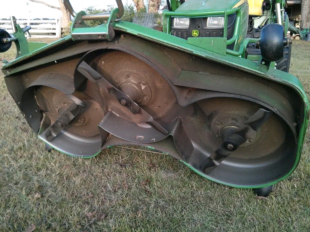

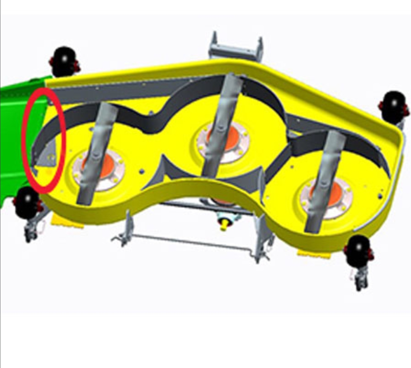

As you can see, ALL THE DECKS configuration and design are VERY similar.
My BX 54" deck.
A JD visual reference, with a proven design that works very effectively and efficiently.
Another JD reference.
And another.
I'm thinking that designing and building a Mulch Kit for the Kubota DECKS would be a fairly simple task.

What do you think would be the difference for a "commercial" mulch kit?
I come to the Kubota BX23 series from a John Deere X739. The previous was a great piece of equipment, though lacking in several areas that I needed. It wasnt cost effective to add a rear PTO and FEL for lack of capabilities afterwards. The BX series was almost identical LxWxH in comparison, plus it was overall more capable.
The JD 54HC deck did great (much better) with the addition of the Full-Time Commercial Mulch Kit, which consisted (as pictured) of the 1/8" thick dividers. It cut beautifully wet and dry for me.
The "kit" Kubota sells (my opinion) is not a true mulch kit as compared to whats available for the JD. That's the part I miss.
I don't recall the price for the kit you have on yours, I think it was $300-$350 area. The commercial FT JD kit was comparable (pre-covid) in price. I'd venture a Kubota commercial kit to cost $450-$500 if they were available now.
Kubota has had commercial kits available for some models, though not the decks designed for the BX Series. Why? It makes no sense. I feel if someone were to design a HD Kit to a mass producer, it would quickly become a top seller.
