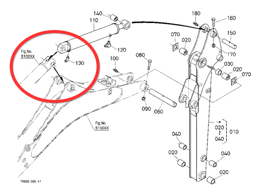

It is still under warranty. While I had the dipper cylinder decoupled I was not able to move dipper arm because the bucket was supported by the ground. Previously with no pressure and engine off and pulling dipper lever I was able to move Arm +| - 2” from a resting position and no noise.
Ordered pins, zerks, spacers and grease lock-on device for grease gun. for this pivot position.
You all have been great. Like good neighbors! I really appreciate your guidance and suggestions.
Next I will replace zerk.
Any further detail on scenario to replace the pin? Laying arm flat on wood while it is attached to tractor? How about using new pin to push out old pin ( but don’t want to mushroom new pin). Type of hammer? I like the idea of a socket head. But, needs to be easier to move than first time or I will change orientation because something must still be creating a load on pin.
Thanks
12,975
5,697
Looking at the single picture with your finger.....
Get a socket that fits nicely into the 'depression' or 'crater' between the zerk and the outer rim, add and extension,or two to be longer than the total width( maybe 6" + 3" extensions ?), use a 4# mini sledge, and use good,firm whacks, say 2-3...and see how far it moves. repeat as required,just be sure to keep socket firm and flat against the 'crater' bottom. The idea is to put concentrated forcenear the centerline of the pin. Having the socket in the crater eliminates the chance of whacking the 'bushing' and/or 'mushrooming' the actual pin. If need be, add another extension to keep precious fingers OUT of harms way !!!
Be well aware that once you push it past the end of the ram connection, it will MOVE. Probably best to do this with it all 'stretched out' on the ground, maybe solid wooden blocks , hear and there ,as required , to keep from moving too far. Safety first...If it takes an hour or 2 to figure out a safe way...it's time very well spent. When installing the new pin... fill with grease first( to be sure it accepts it ) and test fit on the bushing only( no ram end). it should be silky smooth. If not ,remove any burrs or ridges, try again. THEN install and push through the ram end. Maybe have a helper move the correct lever so the ram can get aligned with the bushings. I suspect if everything is well gresaed and aligned ,it'll slide in easily.

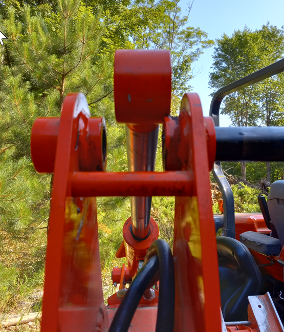

This past weekend I moved the dipper arm pivot pin out in both directions, evaluated, cleaned and greased. Same noise. I then removed the pin from the top dipper cylinder in order to check the dipper arm movement, and doin so I found that the noise was actually coming from the base end of the dipper cylinder. In fact, trying to rotate the cylinder up and out of the dipper arm socket was difficult, for two reasons. One: it was not in perfect alignment with the dipper arm. Two: it was binding somehow at the base of the cylinder where it connects to the boom cylinder. I was able to rotate the dipper arm cylinder up, and as I did it produced the same noise I've been hearing. Once I got the cylinder rotated up as far as it would go, the noise and bind was gone! I could now rotate the cylinder up and down without issue. I proceeded to grease the pin at the base of the dipper cylinder (again), and reconnect to the top of the dipper arm. It took some pressure to push it back into place due to the misalignment, but once it was all put back together, no noises. The question is what was causing the binding and noise at the joint where the two cylinders (dipper and boom) connect? If it returns, I will evaluate that pin. Maybe the noise is because of the alignment issue, I don't know.

Can't tell for sure from a photo, but it appears that the dipper cylinder may be bent, also, the dipper may be bent. You need to disassemble both parts and have a machine shop inspect them checking for straightness and holes not being perpendicular. Continuing to operate with bent parts will cause rapid wear. I wouldn't trust the manufacturer to produce quality parts or a dealer to properly inspect them.
12,975
5,697
Could damage (bends ) have been caused by using the bucket to 'whack' something like a tree stump or 'aggressively' turning/moving tractor with the backhoe ???
hard to tell in pictures, but my old eyes don't see the cylinder/ram being bent rather the boom or arm or dipper stick......whatever the orange steel is called....
Thanks for the reply Lynnmore. The cylinder didn't appear to be bent, but very hard to tell with the naked eye. I may hold my level up to it and see if there are any noticeable gaps.
Thanks for the reply GreensvilleJay. It could be more likely than not, that I did bend the dipper arm somehow. I have used the backhoe to reposition the tractor multiple times while digging. I will definitely make it a point NOT to do that anymore. I picked up that technique from Dad when he had his John Deere 310 backhoe. I suppose those heavy duty purpose build machines are build to take it.
