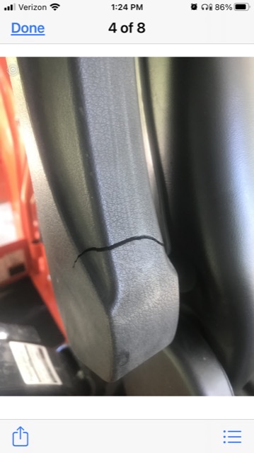

Anyone else having this issue? My padded armrest vinyl has split open twice now. Once a couple of months after purchase and again at only 2 years old. This machine is garage kept and only has about 170 hours of lite residential use. It has in no way been abused. The dealer replaced the entire seat on the first go around and I just contacted them again to see if they will again make things right. I am currently awaiting their response. But neither they, or anyone in google land appear to be seeing this type of issue. Just me. Any thoughts?

Just a thought: Hard to tell from the pic but it looks like the very leading end of the rest where your hand would be?.....Could it be that when you get out of the seat each time you press all your weight on this edge of the rest to stand up and get off the tractor and that lead it to crack?

Or maybe lifting and slamming it against the stops when exiting.. just fishing here!

Negative on the weight on armrest theory. This is the underside near where it pivots. Also, I am 6’2” and 180lbs, so I doubt I am putting more strain on anything mounting or dismounting than any other human would. The trim caps did get gone soon after purchase which was frustrating, but not a huge deal. The cracked cushion, however really does suck. I’m not real fond of spending the rest of my life on a well taken care of shinny like new orange machine with a bunch of gooey duct tape holding the arm rest together. Great tractor otherwise.

Perhaps your argument could be that you had an immediate failure after purchase, and now you’re suffering the same failure with the replacement seat, that was probably produced at the same time as the original seat was.
So therefore it’s likely they had a defective run of seats at that time…
What’s the chances that you could suffer the same thing twice without some kind of severe abuse? Kubota probably knows they had an issue around the time you purchased your tractor.

Any chance you could check any others out at your local dealer? I mean it does look like it would have to be a defect.. have to look very carefully to see if you see any splitting in that area on a new one. I'll check mine if I think about it though it's a 2680 I'm not sure if their the same or not.

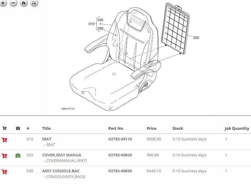

There's a JB Weld 'version' for bumper plastic. I'd take the arm off (download the parts picture...),tape off the arm near split, slowly fill the crack, wait for a day,remove tape, reinstall.....

My take from looking at that seat, is the inner frame has let go internally. Does that arm rest move back further than the vertical position? If that is the case it would very much be a manufacturing defect.(tube weld broke from pivot) I assume you use the arm rest to help rotate the seat to the backhoe position.
Seat is available as complete assembly $908. Sounds like dealer is backing out from you.
Or you might investigate if the seat back(30 $440) includes the arm rests. Which by the images would might be a possibility. The bottom is not avail separate of the "assembly".

As for the comment about the internal support being broke. It is stout when i put normal downward pressure, but not sure if it gives any in the up position. Ill check that this evening. I can see where that could be a hidden possibility.

is the # for the RIGHT arm rest, $210 CDN,no price for the LEFT one ......
