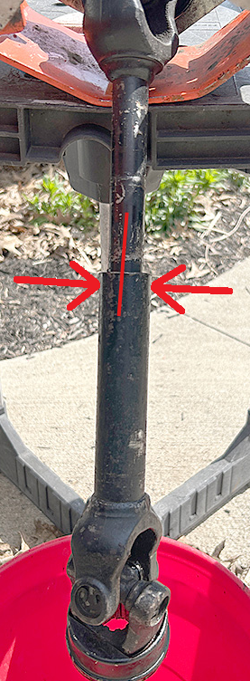

My BX2380 sat outside over the Winter (mower deck was removed), now the universal joint shaft for the easy-over mower deck is seized up. I have tried a ton of PB blaster, heat, etc. I cannot get them to come apart. It will not let me engage the PTO on the mower deck since it will not slide. Any suggestions? I am seeing $500-$700 to replace the part.

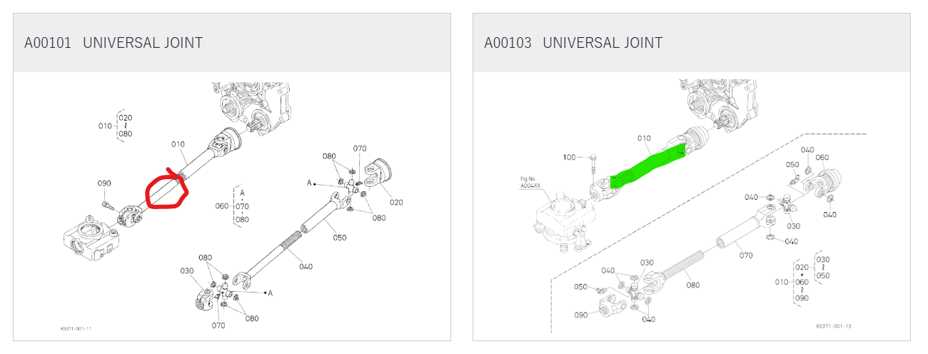

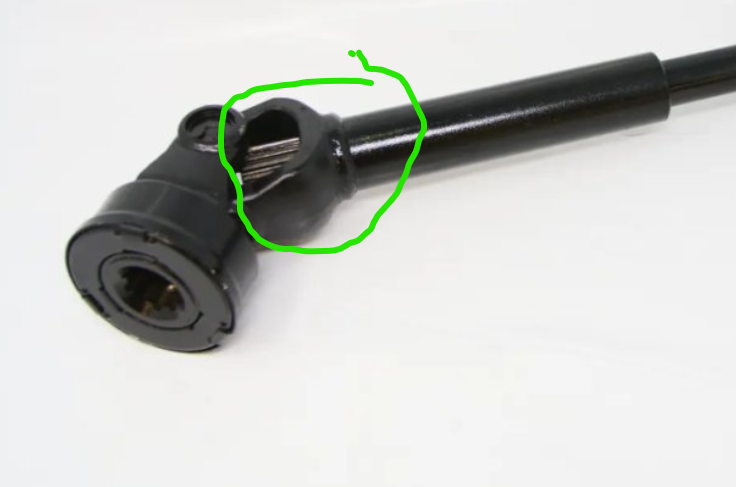

Your shaft is on the left and it allows for dirt and debris to get packed behind the splines, making it Lock the shaft in place.
The new style is on the right and has splines the whole length to keep it from getting junk packed behind the splines.
You might drive the shaft in so the splines pop out the other end ( like this picture ), then wash out the back side.

Please look at the direction it is hanging in post #1. If that was turned the other direction, could you then pour that outer tube ”full” of penetrating oil and let that soak the splines for a while?
I think from your pictures that would work. The come back in several to 24 hours and try to move it together and apart.
I have had success with PB Blaster breaking things loose that were severely rusted but time and patience were required. And there are other equally good penetrating solutions so I don’t want to start that argument (again).

Actually that did it. I sprayed it full last night and let it set until this afternoon. Coming from a Jeep/Off-road perspective, I was weary to try very hard with the ratchet strap idea. I can see on the splines that there is one area with a larger gap so it should be easy to realign. Would it be better to coat it well with anti-seize or grease when I reassemble?
