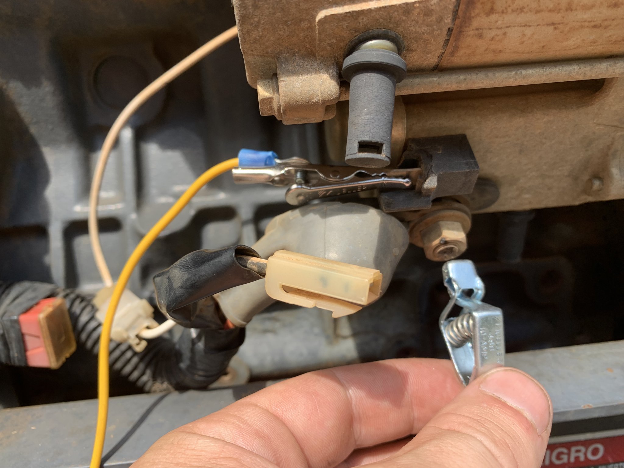

Are Bx’s stop solenoid in the pump or on top?
If on top all you have to do to start, is jump the spade connector on starter to power, it will run. That bypasses every safety there is. Just tried it on a F3680, didn’t run but a second as it’s stop solenoid is in the injection pump.
Just jump this and it will start.
