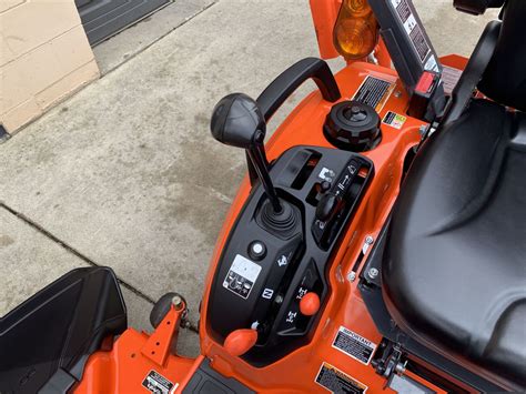

shot in the dark: you didn't per chance hit your hydro lockout lever did you?

Is that a lever available to me while operating the tractor or is it something underneath that could be hit by a rock? I feel pretty sure that I did not. Another piece of the puzzle is that after tractor cooled down, I restarted and with the speed pedal pushed all the way down was able to move it at a very slow speed back to my driveway where it now sits.
should be a smaller lever next to your joystick with a lock symbol on it, I hit mine one time and lost all function, scared the hell out of me. Jiggle it, hopefully will come back to life mine actually rests in the middle of the slot so it's hard to know where its at. I'm obviously grasping straws here

sorry I don't know the technical term.
Right behind the joystick, "C" shaped pathway for the lever.
I think that is just a mechanical lockout for the FEL joystick. When I mow without the FEL on, I keep it locked to prevent the joystick from moving when I mow past low branches or bushes.

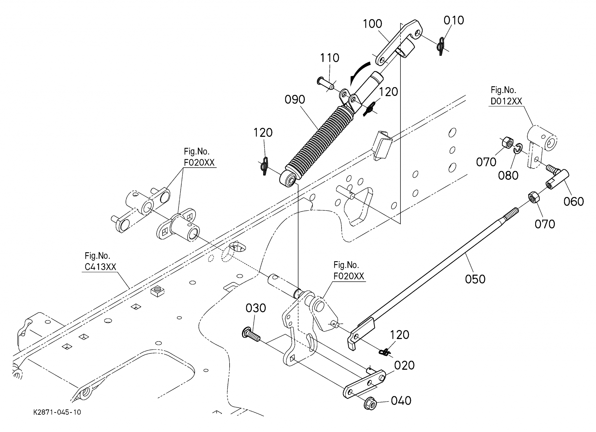

I'm thinking maybe '070' or '120' in the picture may be missing ?
A quick look underneath is kinda important.The rod '050' connect the pedal to the tranny. Should be obvious if it's loose.....

if the nut came off, it's an easy fix for a dealer-and kubota pays for it. And-kubota pays them real well for it, enough that they can pick the machine up and deiiver it back to you and still come out ok. That's assuming you're not more than, say, 50 mi from said dealer.
It's accessible from underneath, rh side. If you have a belly mower on it, it has to come off. if it's a drive-over (aka "easy-over" ) deck, the deck needs to come off and the bracket that holds the deck will also have to come off. I hate those decks. From there its just a matter of using one hand to move the pedal back & forth while you follow the linkage. On the transmission end is where the nut usually comes off. 5/16-24 UNF, and use a lock nut on it. Probably not a bad idea to put a little loc-tite on the nut before screwing it onto the ball stud but be sure to tighten it up before the loctit cures otherwise it makes it that much more "fun". I say it's easy to do, but it's kind of in tight quarters back there like everything is on a BX tractor.
Might not be that nut but at least if you can get under it and watch the linkage (engine OFF!!), you'll find your issue most likely. I figure it's either the nut or the ball joint itself.

That is my post referenced in #8. it was exactly what everyone predicted. The nut #70 in the drawing had came off. It is tight quarters if you have big hands, but an easy repair.
