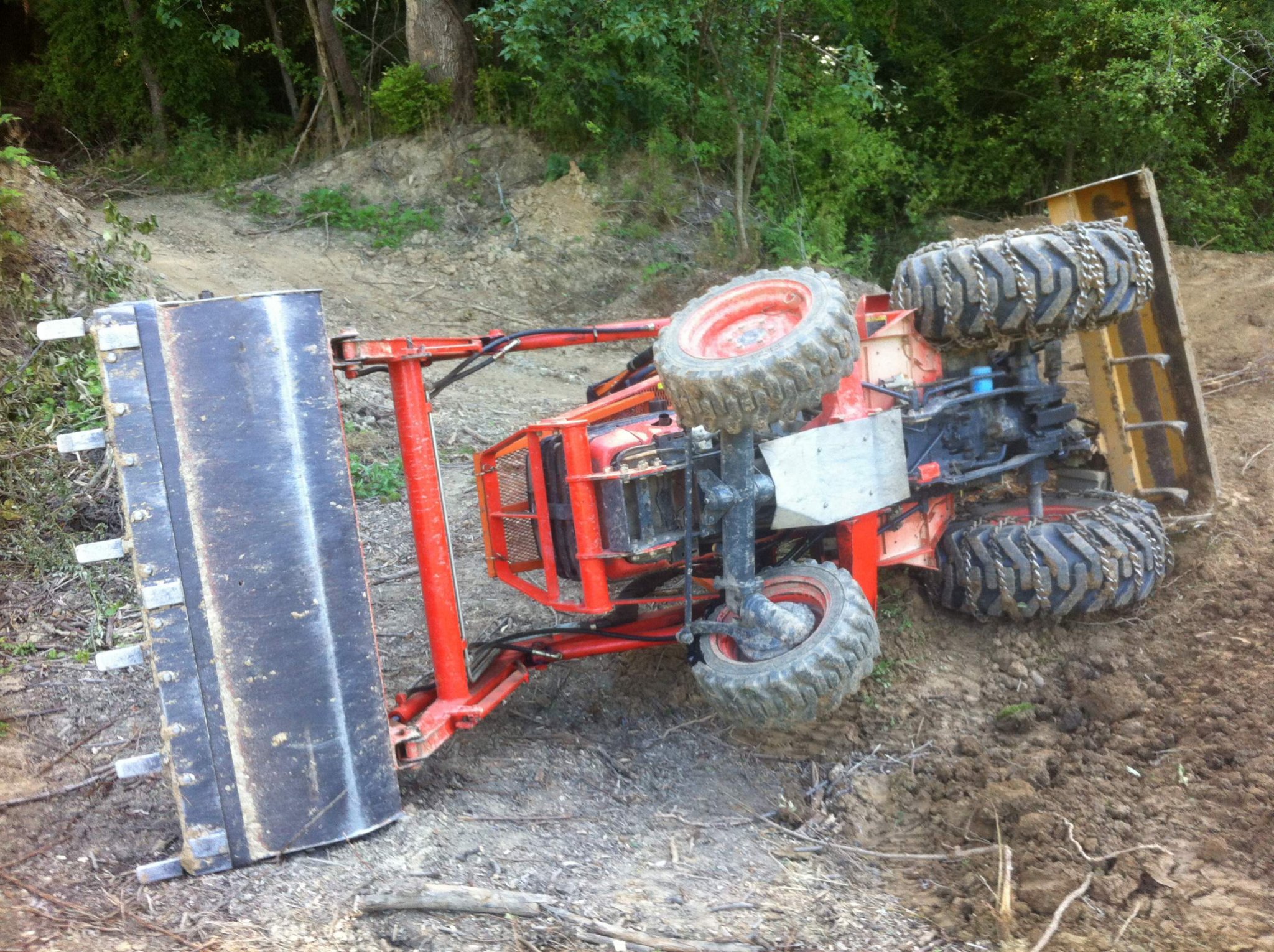

there was a recent posting about this with pictures, luckily the owner got out alive. many don't , lost 2 'fourwheeler' buddies(17 and 19) trying to cross on the slope.

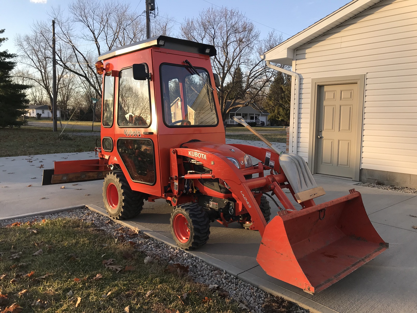

I have a homebrew steel cab I install for cold weather activities. Weights about 365# with its CG about 41" above the floorpan. I have 2" wheel spacers but no wheel weights or fluid. My yards reasonably flat but rough. In the fall mowing leaves, with the cab on, i notice more side-side motion than without the cab. I would never think of driving side hill with that much weight up high. As others have said, avoid side hill situations and if possible add weight down low to reduce your pucker factor. Hope this helps.
