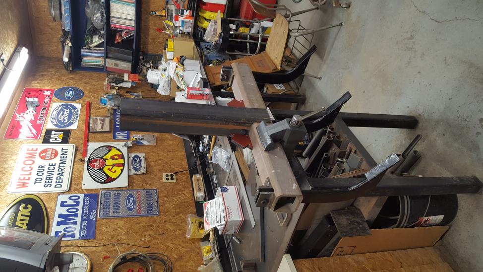

Well I've been wanting to build a ripper for a while now so here's a few pics figured I'd do some show and tell.
Very Nice!! How much did it run you for materials? Where did you source the ripper teeth? Good looking build. Make it dirty!

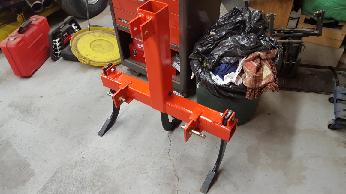

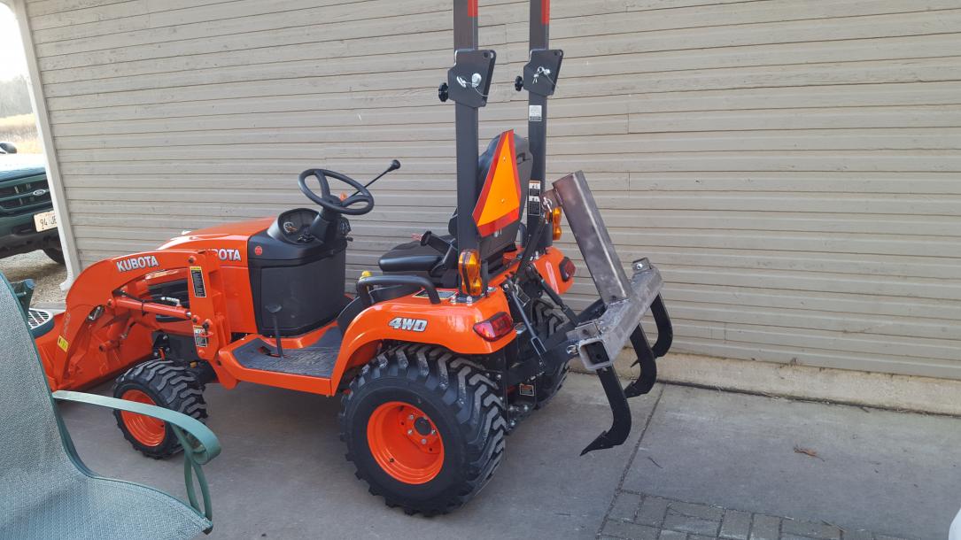

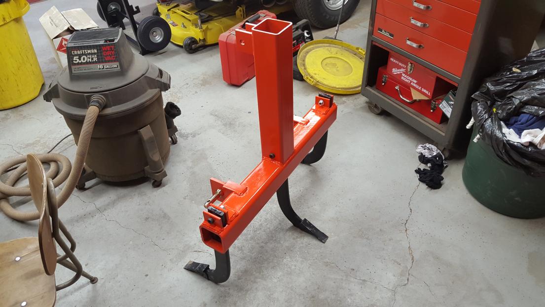

windzer
Bx2370-1
Dec 8, 2015
82
Illinois usa
I played with it yesterday in my neighbors garden she ripped about 9 inches deep with all 3 shanks in one pass with no weight on tractor or ripper .I built the ripper pretty stout she probably weighs 100 lbs or so. the square tubing is 4"x4" for the main tube it's 5/16"wall and the upright is 1/4" wall the and the angle iron is 3/8" thick. I got my shanks from agrisupply onine they were about $18 each I probably have $150 in it give or take i had most of the steel under the bench it was scrap the only pieces I had to buy was the upright tube it was $35. I painted it orange today I'll get some pics posted tomorrow when it's all finshed.
