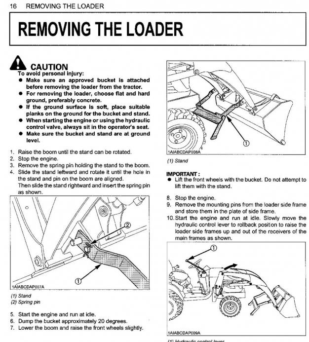

Here are pages from the manual. If you look at the diagram and review instruction 10, you will see a mistake. You will see the attachment part of the arm rotated forward. No way does instruction 10 do that. You have to do a little "lifting" of the arms, by applying pressure to that hydraulic cylinder next to the support area. After you have done that, then the instruction 10 can continue. Otherwise the arms have a "grabbing" half circle that prevents the direct upward movement.
