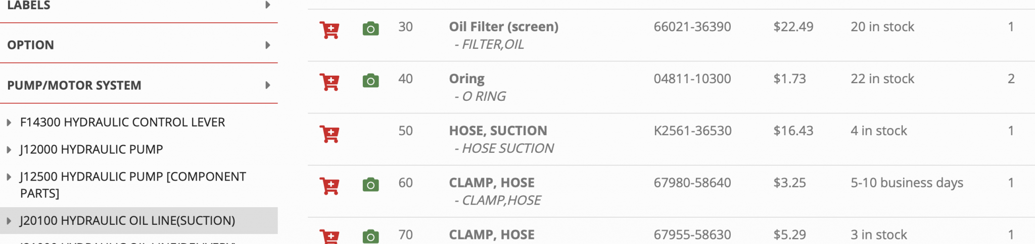

I can't get to the kubota app illustrated parts list cause it don't work with apple safari (been seeing that "we are working on it" for years). On messick's parts list it is under PUMP/MOTOR SYSTEM section, HYDRAULIC OIL LINE(SUCTION). Might be same location on kubota app.
Below is where it shows at messick's:

Look under pump/ motor system.
Suction line

And, my lack of knowledge comes into play here. I would never have thought to look into the pump and suction system. I have followed the breakdown at Messick's and have discovered the diagram of the correct location of that oil screen.
However, it does not explain the reason that the Operator's Manual has the wrong location! BUT, now I know.
Thanks all. We're rolling ahead with continued repairs. Life is good. :)
