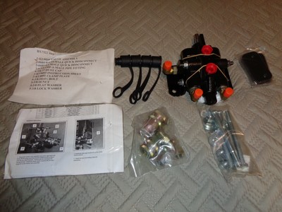

Kubota did many years ago, and I have the one that I removed from my BX22, because the valve failed. It is available as a non working part. Open to offers.
KUBOTA BX REAR HYDRAULIC REMOTE KIT BX7322
There is one listed on eBay for the last year or so.

Kubota sells a 'deal rear remote kit', levers fill that empty slot in the right fender.......
They do for the BX23S, but not for the BX23. I am assuming that since he refers to his machine as a BX23, that it is about 16+ years old, and most of the kits that were sold for those machines are not obsolete. The kit for the rear remotes for a BX23S is $1000+. I have been considering it for my tractor, however, I don't believe that it is worthwhile for me, since I wouldn't use it very often.
It IS possible to install that kit on a
in his 'equipment list, 1st item is a BX23S...so I assumed that's what he wanted it for...
at $1000, not a bad deal for something 'plug and play'.....
Does it fit the BX23s? On the older BX24 and BX25 you couldn't install it du to interference with the backhoe frame. I did cut away enough of the frame on my BX24 to install it but I don't really recommend it because of the weakening that results. ( I rarely use my BH but I do use the remote valve fairly often)
The Kubota rear remote kit will not fit a BX23s due to the backhoe frame. removing part of the frame would be an option but???
