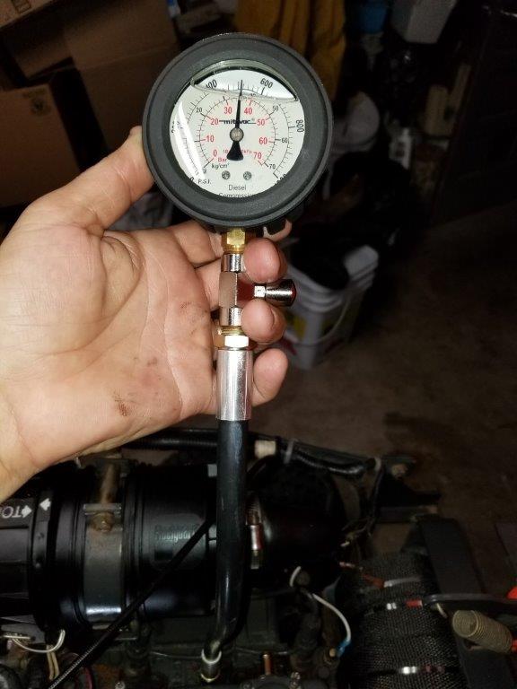

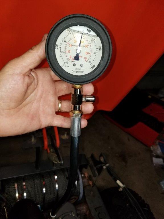

Finally checked compression. Cylinder 1 is 540 PSI, cylinder 2 is 520 PSI and #3 is at about 565 PSI. Is it normal to have a 40+PSI difference between #2 and #3? It would be within the 10 % variance, but I wonder if they should be closer.
The exhaust valve gap on #3 was over .010" so it was more loose than the other valves. Also, that last rocker arm slides sideways about 1 mm. The other rocker arms are nice and snug as the springs keep them that way, but that last rocker arm looks like it could use another shim (washer 16871-14430) unless it is supposed to be loose.

I started a couple of other threads with more narrow questions, and I mentioned in a separate thread that (after Whitetiger pointing me in the right direction) my compression is perfect on all three cylinders (580 PSI). After changing the battery today the tractor starts in about 8 seconds, whether I keep the glow plugs on for 5 seconds or 20 seconds.
Am I expecting too much by thinking it should start within a couple of seconds if I hold the glow plugs on for 10 seconds? That seems to be how the new ones start (I checked at the dealer), but those are direct injection.

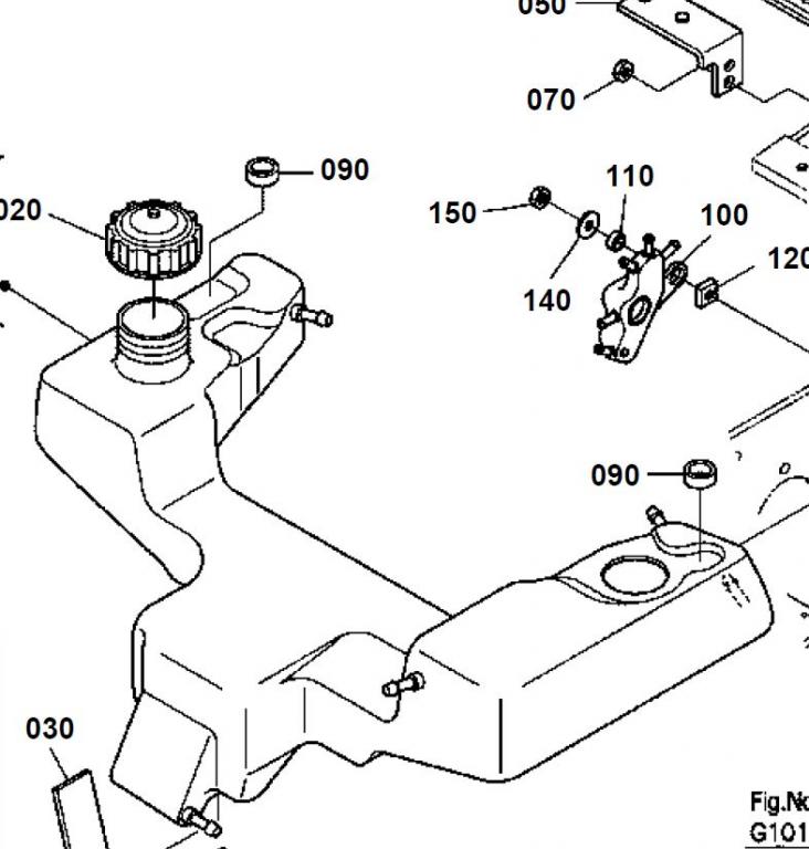

Looked at the fuel lines in the parts manual and WOW! That little contraption under the tractor is a baby fuel tank with 5 tentacles. It is item #100 in the attached picture. The big fuel tank has 4 lines going into it. Would all these lines need to be replaced to rule out an air leak in the fuel system? If yes, I may just settle for starting the tractor in 10 seconds as long as I can start it in cold weather :)
I don't see any actual fuel leaking anywhere and once the tractor starts, it runs well at any RPM. I have run it for about 3 hours in the month I have owned it without doing any work.
