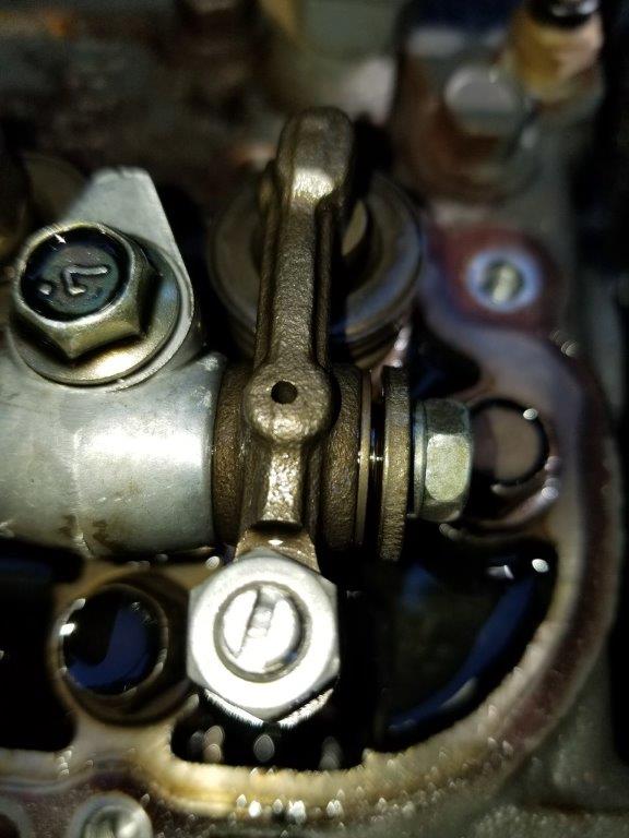

Possibly last question on this topic as I adjusted the valve lash a couple of times after receiving the new adjusting screws and nuts.
The last rocker arm for third cylinder has about 1.5mm (or a bit less) gap on the right side
unlike any of the other ones. I tried tightening the screw at the end but it looks like the only thing that would reduce that gap is another thin washer like the one that is already there (the one up against the right side of the rocker arm).
The question: is that gap supposed to be there for some reason, or should I try to make it smaller by adding a washer?

on my bx
I wouldn’t mess with it, here is a pic of mine, looks like a gap is there too, the springs on the shaft should keep everything where it’s supposed to be. It worked 15 years the way it is, it will go another 30
