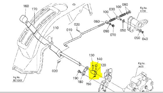

ive tried to look at that coupler and it looks like the rod going into control valve is spinning when moving the lever but cant tell real good do to the fact its hidden pretty well in their i think im going to have to remove fuel tank to get a better look any ideas on the easiest way to remove that looks like im going to have to remove back fenders

I have followed linkage all the way to control valve and nothing broke I took control valve apart and checked flow priority valve relief valve and spool everything looks good cleaned parts up and put back together and still nothing if everything I read is right the power steering also works off the control valve and is working fine I don’t seem to be getting any fluid thru the port that is going to 3ph and don’t understand why and the fact the control valve as a whole is $600 I really hate to spend the money not knowing if that is the problem any insight would be greatly appreciated as this is kicking my butt thanks
