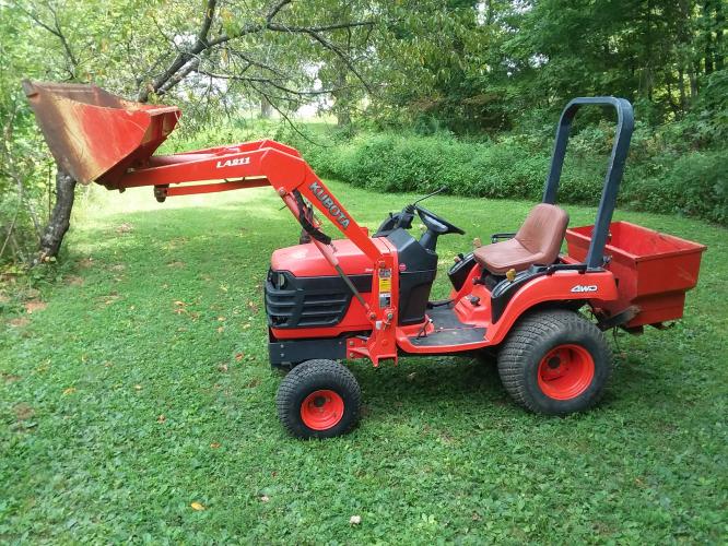

Going to look at a BX2200 with 900 hours Friday.
Don't know the year, but pictures look pretty good.
Has the belly mower and a FEL.
My interest is the FEL for light duty driveway maint. and everything else you would want one for!
I have read good reviews, anything to look for?
I am also looking at a JD 2305 in similar price range with same implements.

I bought it!
Starts easy. Fan in the back was intact.
Oil in rear end looks good, oil in engine is due a change.
Spent a hour on it yesterday missing with the bucket, moving some limbs, scraping some rock on the drive.
All I could find wrong was easy fixes.
Both rear lights on the rollover bar where broken and only one head light worked. The red tail light cover on one side is broken.
This morning I replaced both lights on the bar with a couple from TS. I also made them quick disconnect, from what I read this is a common failure...
I found a broken wire to the none working headlight, it is now working.
Ordered a lens cover from a local dealer, should be here middle next week, less than three bucks.
I need a 5ft blade, I have a couple of feelers out. Rural King has them for less than $300, so I won't wait too long.
