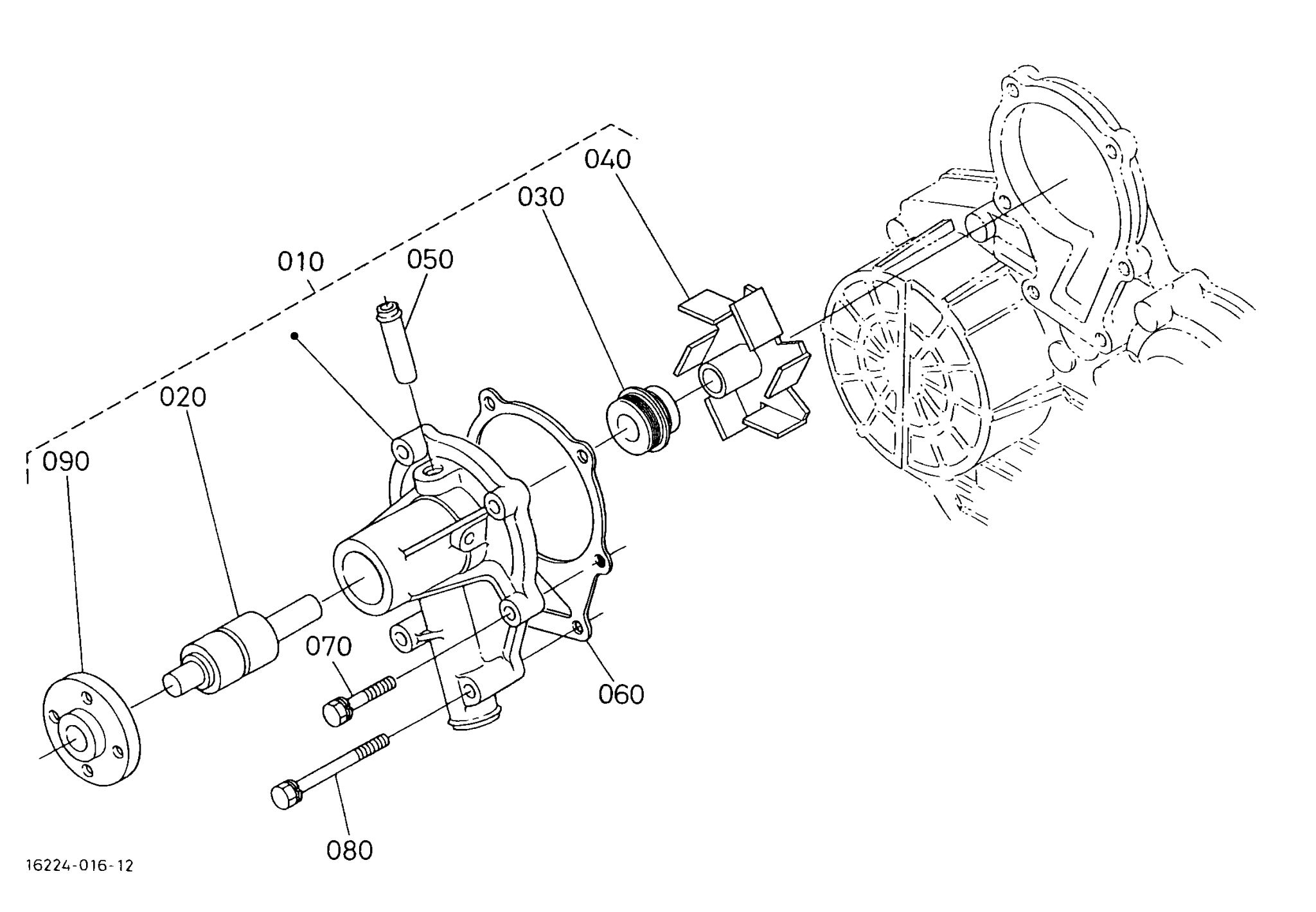

I have a BX22 bought new in July of 2002. A little over a year ago when replacing the power steering hoses I noticed the water pump was weeping a little
so I ordered a replacement pump from Messicks. Two weeks ago the BX started leaking engine oil out the front crank seal so I ordered the parts and pulled
the engine. Replaced the seal, put a new thermostat in it and went to swap the water pump and it doesn't fit. The impeller on the new pump is about 3/8" or 10 mm larger than the old pump. Comparing the gaskets I believe the bolt pattern is slightly different too. I called Messicks and the parts guy was going to look into it and call me back. Three business days later I called them because I hadn't heard anything. I'm quite sure he hadn't "looked into it" at all. Anyway there is only one part number for the pump and that is the pump I got that doesn't fit. Can't return because of how long ago it was sold. Maybe I could rob the seal out of the new pump and put it in the old one so it isn't a total loss. I had to put it back together with the old pump as I needed the tractor before I had any word back from Messicks. Has anyone else run into this problem?

cuious... looked BX22 up at KubCda...
No code has to be inserted here.
TWO different pumps ! based upon serial number
also says different rad for Au/NZ......curious, maybe better cooling ? or right hand drive version ??

My serial number is 50941. The part number I have is 16251-73037. That part number replaced part number 16251-73034. He had no idea why the part number changed.

The old pump has 08511 casted into the body of the pump. It also has a 3 under the manufacturer logo (BTK). The new pump has AF14 cast into it on the neck and a letter B under the logo. The new pump casting has 2 bosses cast for the bypass with only one drilled and tapped. The old pump only has one boss.

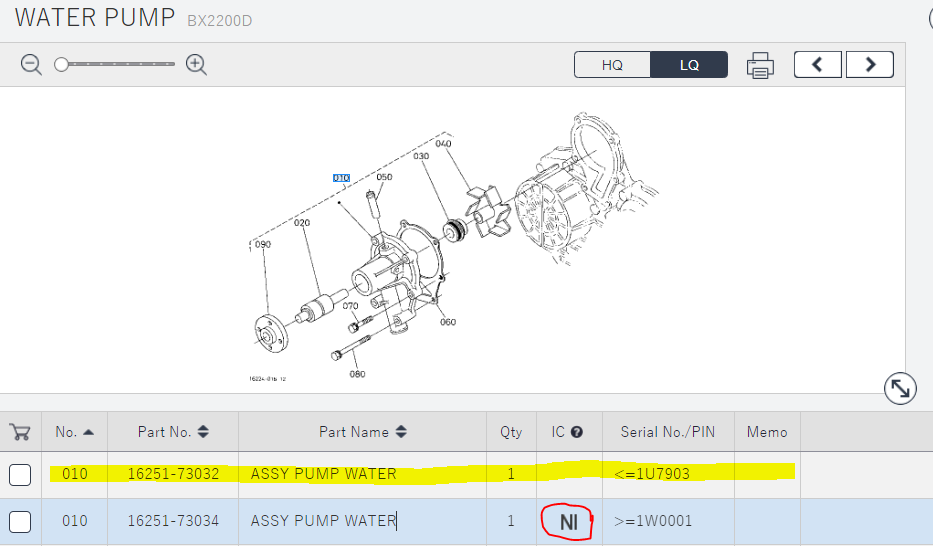

Not to disagree, but when I looked them up, the bx22 shows one pump, and the bx2200 shows two, 1625173032 for serial numbers, < = 1U7903 and 1625173034 for serial numbers = > 1W001. So ???
Well my engine s/n is U7031 so IF the 22 was the same as 2200 I would need the 161625173034 but that number was lined through on Messicks part page.
None of that means anything.
You have the wrong pump!
You need:
Pump: 16251-73032
Gasket: 16251-73430
Curious as to what the real full model number says on the ID plate?
A lot of people think they have a BX22 when in reality they have a BX2200.
The hood's or logo's were swapped during production.
There also was some Quirks to the BX22's and BX2200's!
If I remember right they ran out of the original engines during production and had to swap to different engines.
If you notice your serial number falls in the first pump and not the second pump.
And if you see the NI (in RED circle) that means the two do not cross over.

Thanks Wolfman. The tractor is a BX22MLB serial number 50941.
