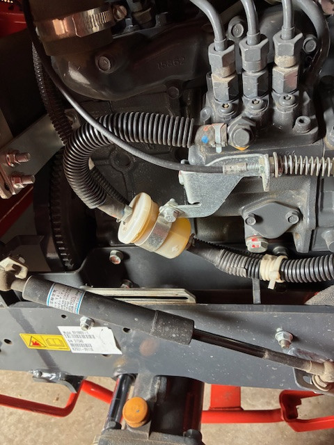

Found the one by the injector pump. Haven't crawled under to find the other one yet. Have read posts about a water/fuel separator. Just wondering if our little tractor needs something like that.
11,055
2,973
There is no fuel/water separator. The filter you see in your picture is IDENTICAL to what you will find up under near the tank.
Get a good pair of hose pinch clamps to cut the flow of BOTH ways ........... remove filter and replace. If you do not get any diesel on you, or rather bath in it...... you will be better than most! ;) :ROFLMAO:
Once you finish replacing one or both. No need to bleed the system - turn key to the on position - you will hear clicking ....... allow a gooood 30 or more seconds, it will push any air through and the tractor will/should fire up.
