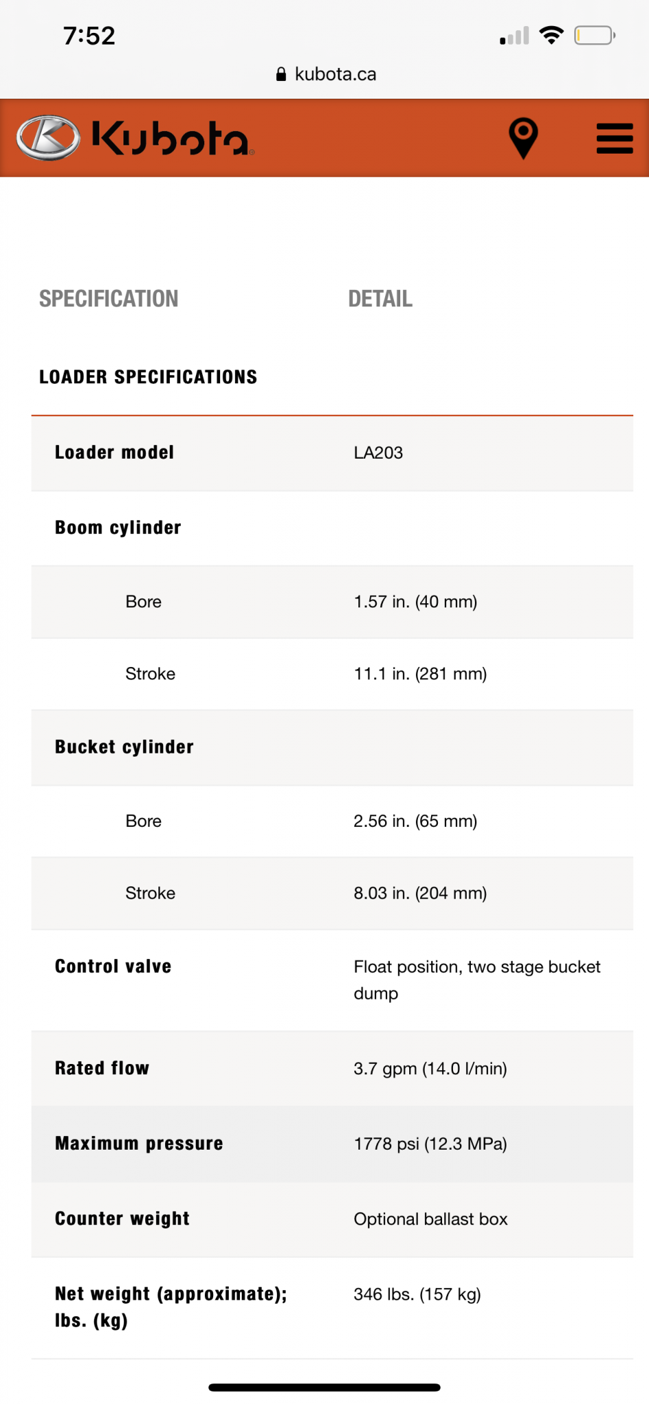

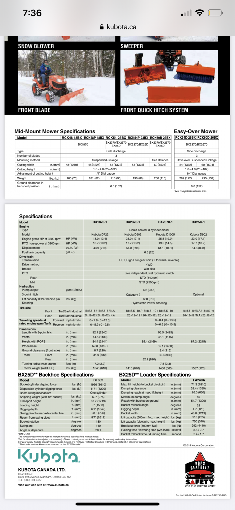

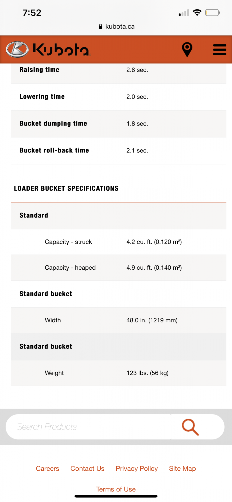

From Kubota
tractor 1345
Mmm 165
loader frame~346
Bucket-123
1979lbs?

That loader is a lot heavier than it looks.
I haven’t seen a BX but I couldn’t imagine the loader frame and bucket only weighing 150 lbs. And they likely list the weight separately because other models have different bucket options 🤷‍♂️
