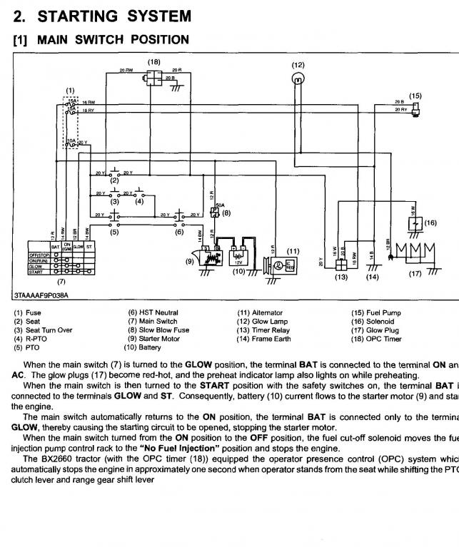

Ok ....my first thought is to throw another battery in the mix, just for sheiets and giggles......knock out that part as a problem......
then i would see if you have 12v + on the starter side of the solenoid with the key turned.....
Could have a bad ground..........
hell could be a bad switch, but I am betting on a weak battery, bad connection or a open circuit........

Check the condition of the battery cables inside the connection and the battery posts. A "new" tractor that sat on the yard for some time before selling may have corrosion and also the cables may not be tight enough. I have had this problem with new cars and tractors from time to time, all related to connections. Some are temperature related, due to metal temperature expansion properties. While you are at it check the connections of cables to the ground as well as the starter. Play with the switches, such as the seat, pedal, PTO for both front and rear selector, etc, since they may have some corrosion. Cleaning up all connections is a must when these things happen. While some current may get through, sometimes there is enough resistance that the starter relay won't work.
Remember the starter also must be grounded. Ya never know where the problem is in the circuit. Did you try the direct connection from battery to starter between the two starter terminals as a method to quick-test to by-pass of the safety switches and the ignition switch.? Don't ground them! If that works, the problem is not battery hot or grounds, but in switch circuit.

Thanks so much for your good information. We don't have the wiring diagram to this new BX2370 but did suspect that there wasn't enough voltage getting to the starter. Tractor was picked up by the dealership about 20 min ago and prior putting it on the flatbed (using a wench) the rep. tried installing a new starter switch which didn't work. They brought our old Cubby Super tractor back so at least we can mow the grass. Will post when the dealership resolves the problem.

The dealer had the unit for a week and finally determined it was the stater motor itself that had bit the dust. They had also replaced the ignition switch prior to taking our tractor.

Dealer claims they replaced the primary wiring harness and it's as good as new. I reminded him that it was new but it crapped out anyhow.
