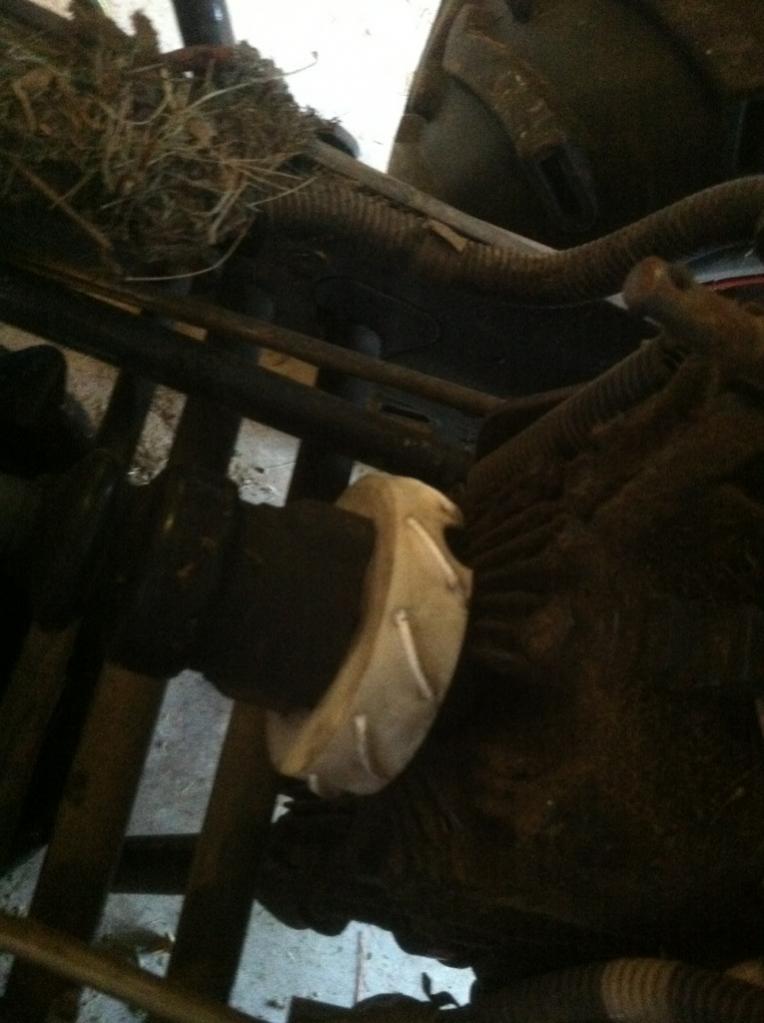

Seems to me , I remember someone splitting the fan in half and installing it as 2 pieces.
I had seen that posted elsewhere. Can't remember where though. They said something like cut it in half and use super glue and zip ties to put it back together. judt make sure you have the fins going in the correct direction.
You would think that it wouldn't be to hard for Kubota to fab/make a replacement fan that would be pre split and bolted back together. Even if they would charge 3-4 times as much as they do now it would be worth it.

Messicks sells the fan online for $10. My dealer cut the one side of the fan all the way through. Twist the two ends open and slip it over the driveshaft. Bolt it in place and tighten everything up. Dealer says it takes about 2 hours to do the job. Cost me about $120 total.

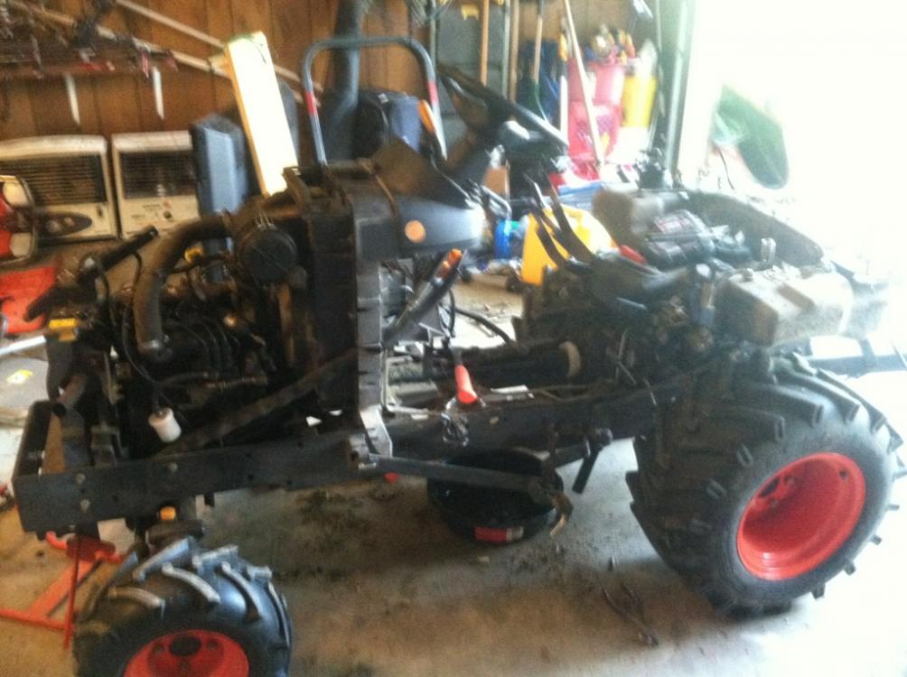

Took me maybe 3 hours tops to take apart. Pretty straight forward just kinda time consuming. Would go a lot faster with an extra set of hands. I'd say I'll have it back together in under 2 hours now that I know where everything bolts mounts and goes. Let ya know when I'm done!

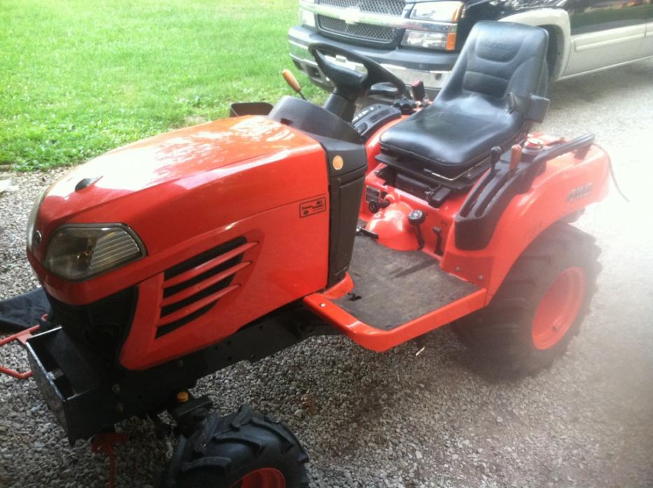

It's still naked...:eek:
Where is the FEL, Backhoe, ROPS, MMM, wheel weights, LED work lights, cup holder????;):D:p
BenRich
BX1870D w/FEL, Land Pride FDR1648 Mower, Land Pride RBO560 Scrape Blade
Good job. I hope I don't have to tackle this someday as I have the BXpanded armor under my BX1870 (no mid-mount mower). However, if I do, it's good to know that it can be done by those not afraid to try.
