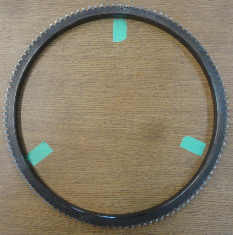

I dug out my old ring gear and took some pics just for show and tell. Here's the old one with green tape marking the 3 areas of high wear spaced 120 degrees apart.

Here's a pic of the area between those high wear areas. Very minimal starter engagement ever took place in these areas which kinda supports the idea that in a pinch you could remove the ring gear and just rotate it 60 degrees (for 3 cyl. engine) and reinstall it again.

I can't recall how many hours were on the tractor (JD750) at this time but it was probably pushing close to 2500-3000 hours. It now has just over 4K on it. A lot of work has been performed by that 20 HP tractor over the years!
