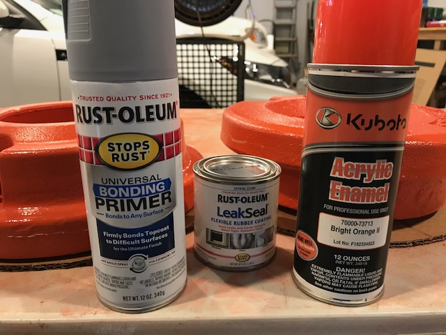

Finally got the weights all finished.
Used 1/2" x 6-1/2" Carriage bolt to attach weight to the rim.... wish they made a 6-3/4" carriage bolt.... as that would of been the perfect length.
I also used some "leak seal" and applied it to the inside of the weight.... to put a rubber barrier between the rim and the weight.... Hopefully it will prevent the weight from scratching the rim.
The old bolts were only 6" so the garden tractor that they were most likely attached to was not as deep of a rim.
The weights fit rim PERFECTLY !

I use Chevrolet orange engine paint, since it matches the Kubota orange perfectly, and I also have a 1962 Chevrolet, and always have the paint in the garage for touch up on my engine.

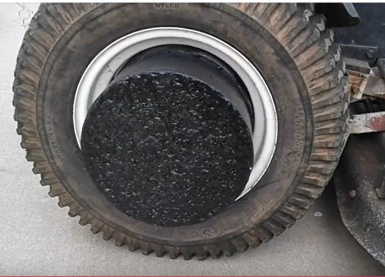

I turned mine from some scrap slugs. ~50# each, 2 per side so I've got about 200# and they don't stick out past the tire to catch on things.
Those look store bought, nice job. I like the notch you cut for the valve stem.

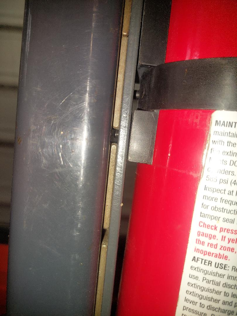

Side note - I don't want to steal the thread but how'd you attach the fire extinguisher bracket to the ROPS?
Thanks, notch cut with 1.5" ball end end mill. Plastic extinguisher bracket screwed to 1/8" plate attached to ROPS with neodymium magnets.
