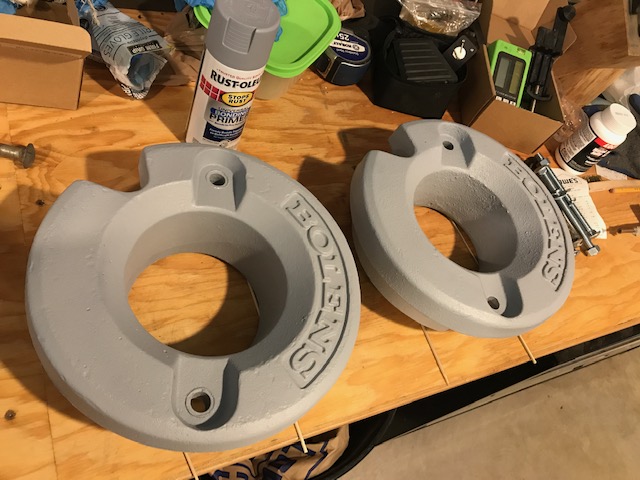

Well, I purchased a set of Bolens wheel weights on Epay, They cost $165 shipped (shipping is $20 per weight)
I soaked them in: Evapo-Rust The Original Super Safe Rust Remover, Water-Based, Non-Toxic, Biodegradable, 1 Gallon..... It was $17 on amazon
I then decided to use my Grinder with a: Radnor Knot Wire Wheel 4" X 5/8-11 Standard Twist
I went to the Kubota dealer and purchased the Orange spray paint ($15 for 1 can!!)
Now I just need to figure out how I should Prime them (I think the weights are Cast Iron).... and I have run into allot of do this, do that... use this, use that :eek::eek::eek::eek::eek::eek::eek::eek:

Sometimes we have to pay the price to get what we really want. Good find and I bet theyll look great when youre done with them. Looking good already! -Brad
nice find! those will come out great
I did something similar with 40 pound john deere suitcase weights, used a wheel to sand them down, shot them with primer and sprayed them kubota gray. They have been up front running over brush, knocking around and the paint is still fine. I did learn an important lesson, to never sand iron while on your asphalt driveway. :eek:
