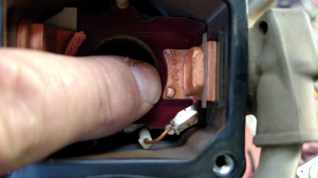

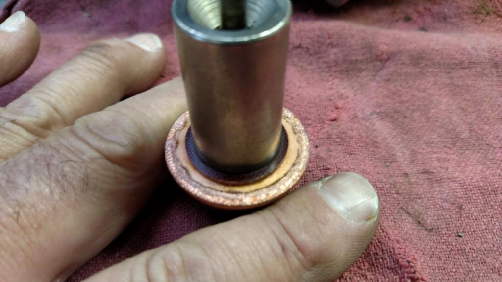

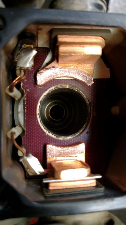

So, I took the starter off, pretty easy after you remove the engine cowl. First thing I checked was the solenoid contactor, and while the contact plate looked pretty good, and I have seen some with holes burned completely through, there was a little tit of copper on the contact that goes to the starter motor. You can see quite plainly in the third picture. That would definitely would be a high resistance point with all the current going through it. I cleaned up the contact plate, scraped the little piece of copper off the motor contact and cleaned up both contacts so they will make better contact.

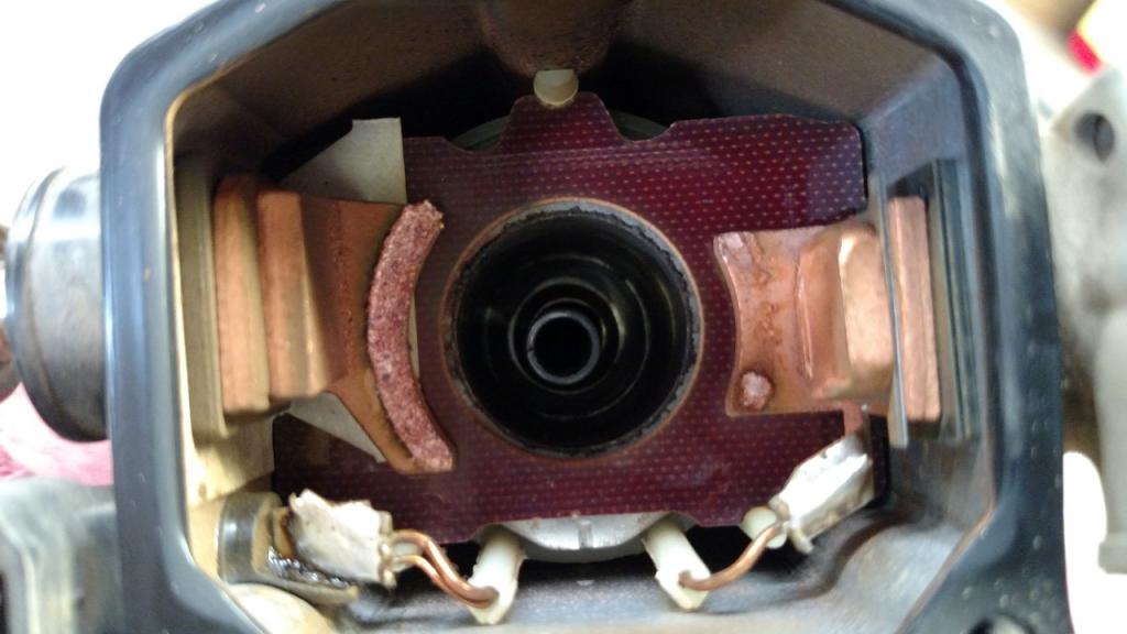

I pulled the end cover off the motor and the brushes look pretty good, probably 3/8" long or so, the brush holder doesn't look like it had been hot, and the armature looks fine also
I put the starter back together and put it back on the tractor, and now it does turn the engine over faster that it did before. It doesn't hesitate before it starts cranking like it did before.
