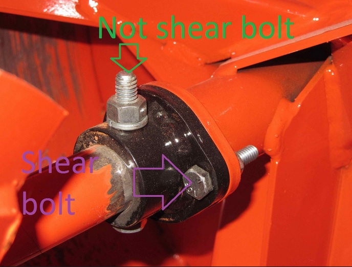

A caution for you to consider.
The fan shear bolt style on the model you posted a photo of was a problem.
At some point RADCO, the Quebec Canada maker of the blower for Kubota and John Deere, changed the design in this area.
The new design has flanges for the shear bolt rather than the shear bolt going through the fan shaft.
The black flange in the photo was a retrofit done by a dealer. I do not know if this part even has a part number.
The first photo is what I think the unit you are considering has.
The second photo is the mod one dealer did for their customer.
New blowers have the flanged style but everything is orange

I am not saying stay clear but buy being fully informed.
It has been at least 3 years since the rash of shear bolt failures started.
Kubota aka Radco were supplying a changing variety of shear bolts and if an owner used the wrong ones a gear box destruction could happen.
I have attached a picture showing the auger shear bolts with two grooves cut into them.
Dave

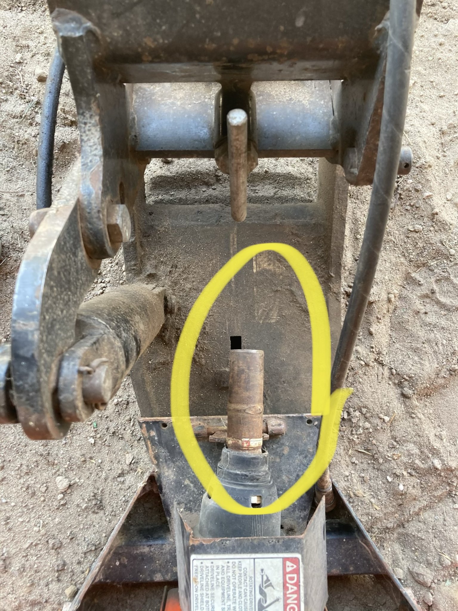

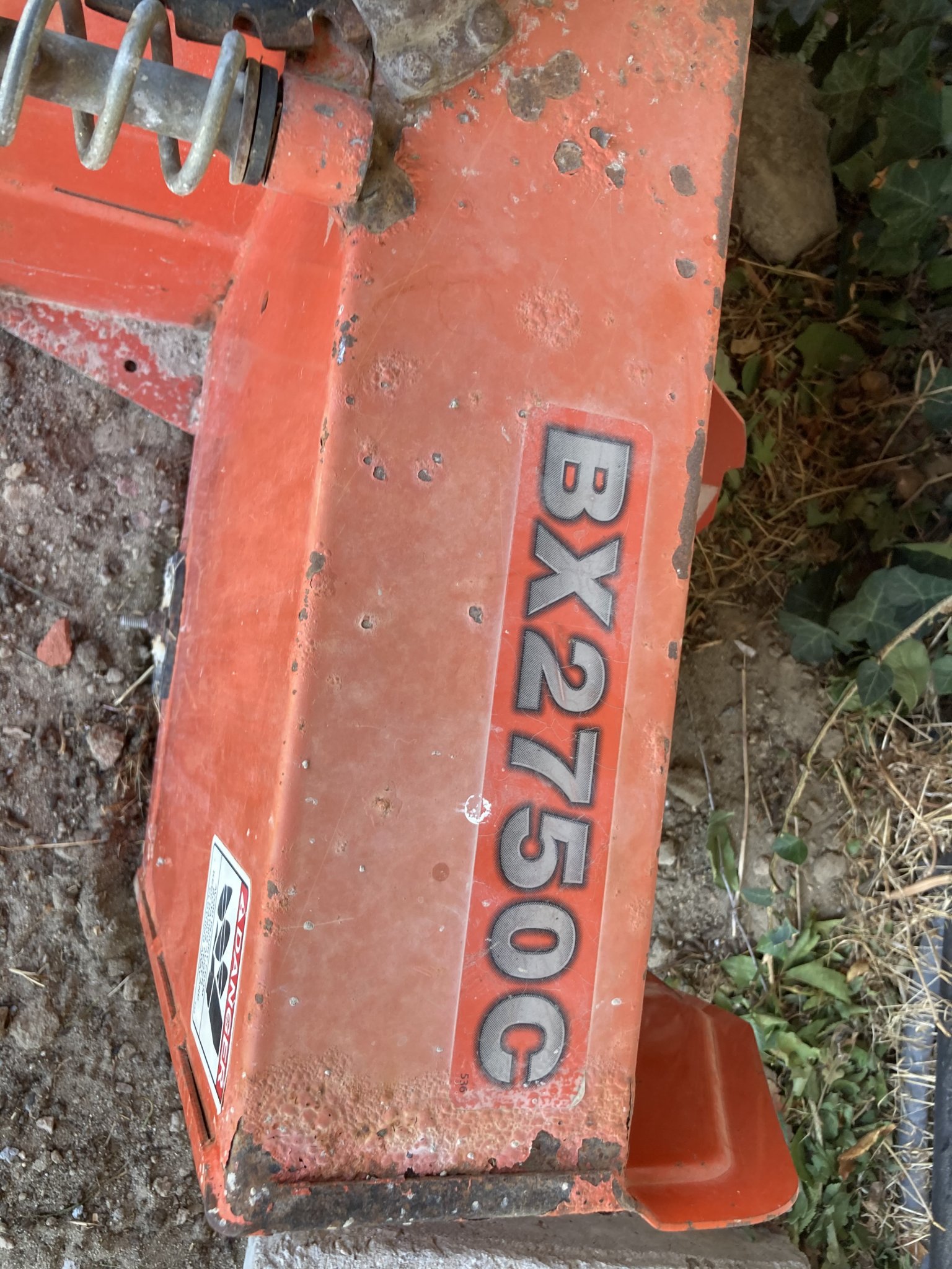

Hey everyone, I know this thread is a few years old, but I'm wondering if I could get some help for a similar situation. I have a 2005 B2320 that I've been using to plow my driveway with for years. I already have the B2733A quick hitch/subframe that I've been using for my plow. I recently came across a good deal on a bx2750c snow blower ($250) and I'm trying to figure out what I need to make it work. There's one piece sticking out of the blower (circled in yellow), but I have no other drive shafts or connectors.
I've talked to two separate local Kubota dealers and they're both having a hard time confirming what I need. One had no idea, and the other told me I would need all 3 of the following:
-B2788 Mid PTO Driveline Kit,
-BX2735 Front Male Driveline Kit, and
-B2736 Front Male Driveline Kit
It seems strange that I would need both the BX2735 and the B2736. Can anyone help me out?
On a separate note, the blower has the electric chute rotation module on it, but no wiring for a switch of any sort...any ideas on what I'd need to make the electric chute rotation work, or if not that, what a part would be to just get the manual chute rotation and hook it up?
Thanks in advance for any help you can provide!

You would need one or the other based on the blower. It looks like your blower is a BX2750 so you would need the BX2735 and not the B2736. The original post was mine and I did get all of that working. My issue was they actually gave me the wrong shaft the first time.

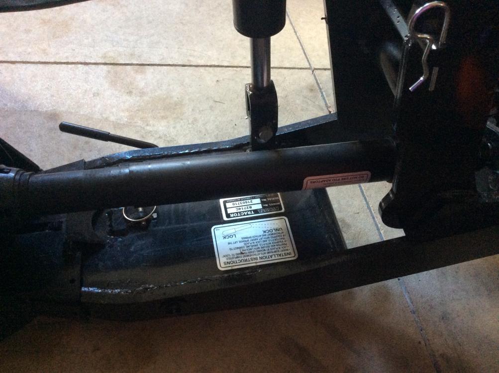

My tractor is up at the Lake House (75 miles from here) so I can't look at it but I have put it on several times now so pretty good memory of it. I only bought the following (shown below)
I had to buy the subframe as I did not have one. The B2788 (long shaft) goes from the PTO in the middle of the tractor up to the sub frame. The BX2735 (short shaft) goes from the sub frame to the blower (BX5450 in my case). Those were the only pieces I ordered and I started from scratch so if you have the tractor and blower, you should only need the other three items (unless you already have sub frame as well).

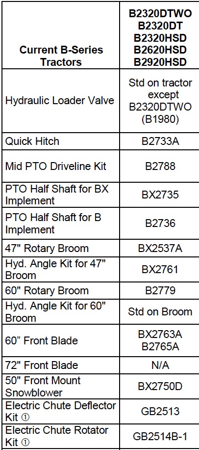

Thank you all for the quick responses, what a great forum! KLPaint, pictures would be great when you get around to it. Where do you find that the BX2735 goes with the bx2750c blower? Is it from the attached page in my manual for the subframe(B2733A)?
I think my b2320 should be the same size as your b2920(other than the engine), so I'm guessing it should all work.
It's unfortunate, but I want to make sure I educate my kubota dealer appropriately :).

Does this help?
10,056
6,873
Wasatch - - if you look at Kubota's parts diagrams, it will show what Kevin's B2788 mid PTO kit looks like.
Agree to legal, then put in B2788 for model search.
Can do the same for your BX2750C blower. Diagram shows the female end of drive shaft as a blower part, but that's missing on yours. Guessing you need both halves.
