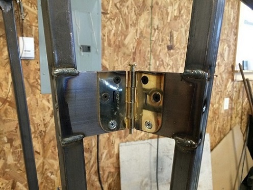

Reamer,
I just used standard interior door hinges, with one of the half knuckles removed. I had these laying around, so I used them instead of buying the weld on - lift off variety. Cab frame is on the left, door frame on the right. See attached.

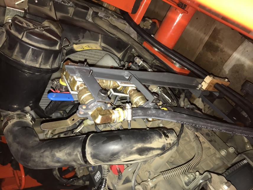

Bringing On The Heat:
Well, I got tired of waiting on my brass SAE fittings to show up, so I buttoned things up as best I could in order to be able to enjoy heat for any future snow cleanup this winter. I'll install said fittings and hard plumb the heater lines inside the cab when I pull the cab this spring. I've read that if a hose burst, the hot coolant spraying all over you may not be the most pleasant experience! I'll risk it for another couple months and fix it over the summer.
I did take the opportunity to warm the tractor up and 'play' for about 45 minutes. Outside temp was in the high 20's but, I was impressed with the amount of heat these little heaters put out. I do believe the days of insulated bibs, coat, hat, gloves are over. And, the grand daughter seemed to approve of my heated cab as well!
Attached are pictures of how I cobbled the plumbing together.
Hope you enjoy.

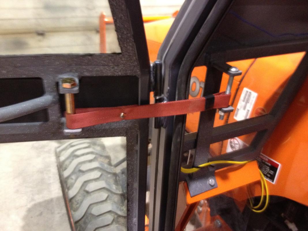

Not Ping, but another way to skin that cat. I used short pieces of 1/4" pipe. The lower piece of pipe is welded to the cab frame and has a captive 1/4" rod. The top piece of the hinge is welded to the door frame and slides down over the pins. Easy on and off (especially if the pins are different lengths). Door latches are stainless paddles like they use on truck utility bodies.
I revised the inside of the latch after the attached picture. It involved sleeving the short piece of threaded rod to make it stiffer.

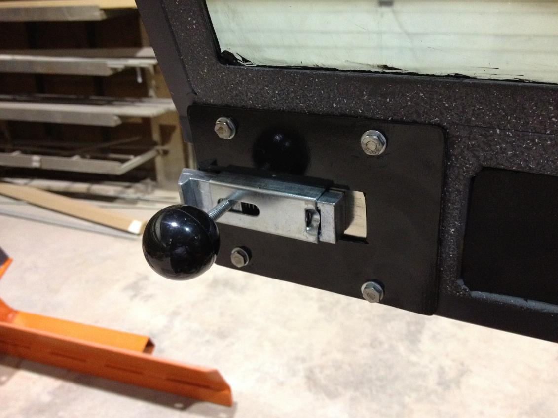

Note that my front and rear windows are held closed with a friction knob, see attached. Only the doors are held closed with rare earth permanent magnets.
